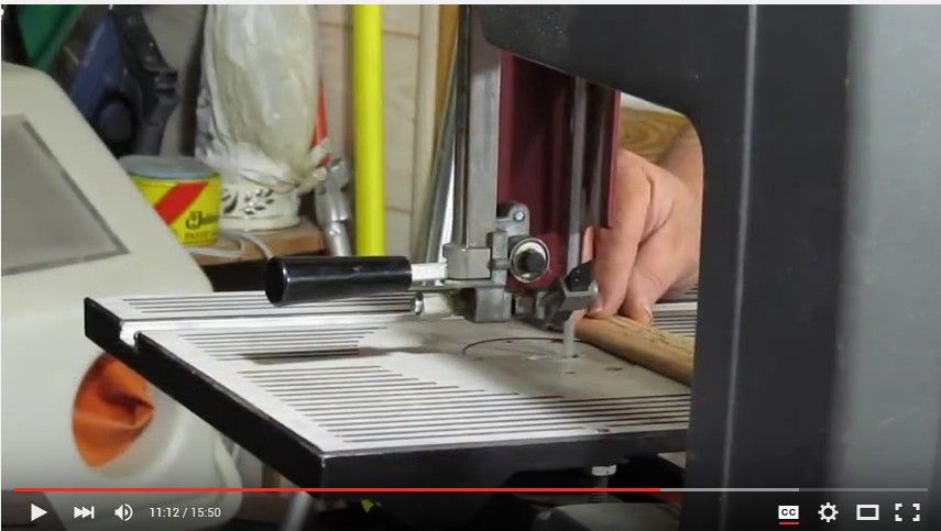

I may have misspoken, slightly. I went to his youtube postings and started by watching this video:
https://www.youtube.com/watch?v=IMRO4CZ6-hI
This was an earlier video then the ones referenced. This is what I was speaking about:
ScreenHunter_83 Jan. 10 18.42.jpg (51.19 KiB) Viewed 8730 times
You can also see how loose the tire was on the saw when he takes it off if you care to.
After watching this I guess I became confused as to which video contained what and posted what I did. He does better in the two listed videos. The one I referenced above is the one I had stuck in my head. Sorry.

reible wrote:I may have misspoken, slightly. I went to his youtube postings and started by watching this video:
OMG!!!!!
Just to clarify proper positioning of the front upper blade backup bearing, the blade should just barely clear the bearing when NOT cutting and should contact the bearing when feeding the workpiece. That is the ONLY bearing that is adjustable in that direction. The other two(rear upper guide bearing and front lower guide bearing(under the table)) are NOT adjustable towards/away from the base. The other thing that is unique re the SS bandsaw is the wheels them selves. The outer surface is flat(with a rear ridge), but also very slightly beveled and the upper wheel is canted(top in) at twice that bevel angle. All that should cause the back of the blade to track about 1/4" from the back of the wheel. The blade moves in a plane that matches the wheel bevel angles so the blade rides flat around the wheels. If not about 1/4", the upper wheel cant is wrong.
At least he did correct things in the other two videos.
