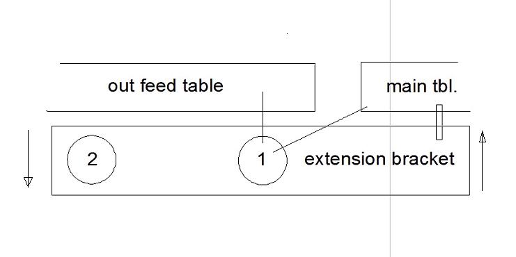

One of the things you can do with Dusty's setup is to adjust the pitch of the auxiliary table. I have an attempted explanation of the major purpose below. The main purpose is to stabilize the auxiliary table.
Trying to get us onto the same page, here's a crude drawing of the set-up Dusty used in this thread and on his new avatar.
[ATTACH]1547[/ATTACH]
What I tried to display is the SS table bracket. The #1 circle represents the main table tube. Both it and the small upright rectangle are "attached" to the main table. The upright rectangle represents the height adjustment screw on the bracket. It is attached to the main table from the upward force (teeter totter effect) caused by the downward force of the extension table. (The heavier the table the more upward force at this point.)
Both circles #1 and #2 (tubes run thru these circles) are connected together by the "L" bracket. In this way, because of the "L" bracket, the auxiliary table cannot pivot without first breaking the "L" bracket from the auxiliary table.
Since in this configuration, the auxiliary table's position is fixed by tube #1 & #2 - and tube #1 is fixed to the table as is the adjustment screw (vertical rectangle) the auxiliary table cannot swivel down. The SS extension bracket, the "L" bracket and the tubes work together to make the auxiliary table a unit that is stationary with any movement (vertical or tilting) of the main table.
