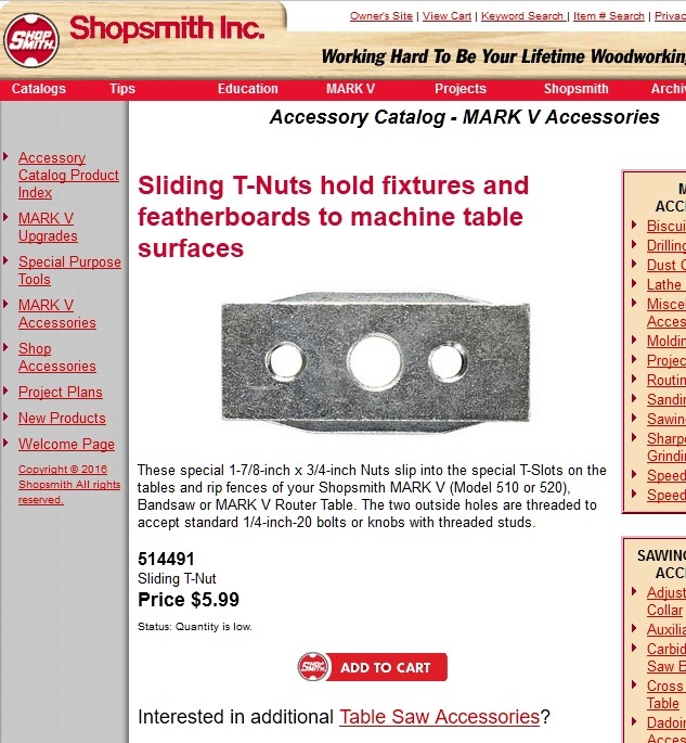

by reible
Well if you get part 514491 it has two 1/4-20 threaded holes, the other hole is there but threading or not threaded it isn't listed, as seen here:
http://www.shopsmith.com/ownersite/cata ... ngnuts.htm
ScreenHunter_153 Apr. 18 22.21a.jpg (251 KiB) Viewed 10070 times

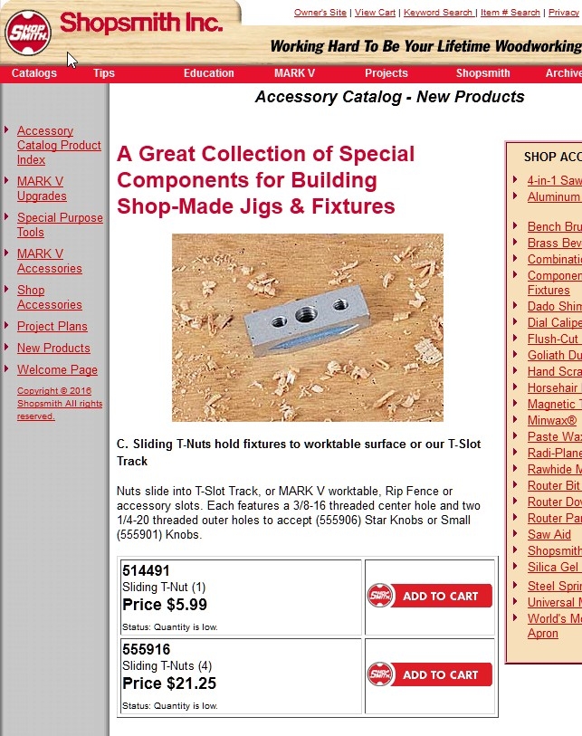

However if you go here:
http://www.shopsmith.com/ownersite/cata ... turesC.htm
The same part is listed as having all the holes threaded.
ScreenHunter_154 Apr. 18 22.24b.jpg (320.92 KiB) Viewed 10070 times
So I have a feeling it could be pretty hard to tell which one you get.......
