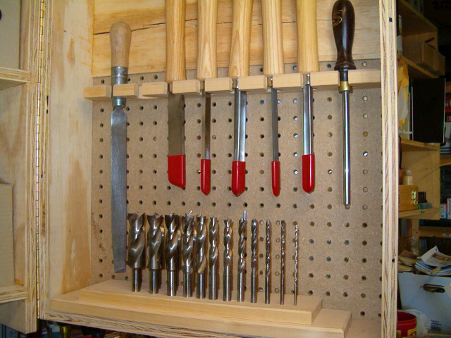

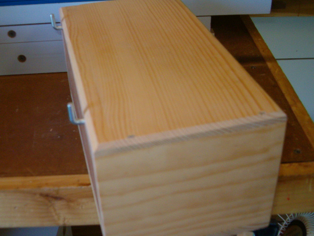

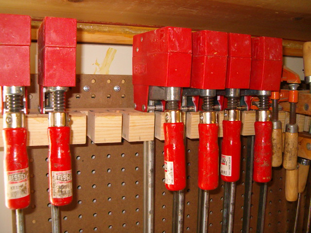

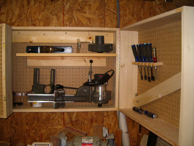

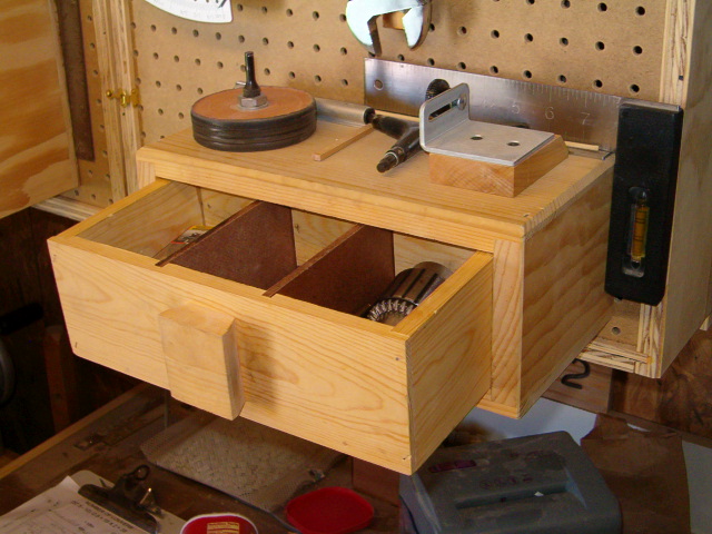

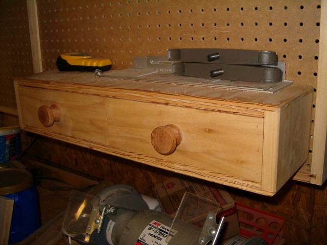

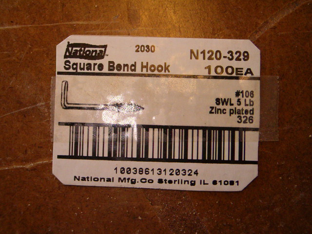

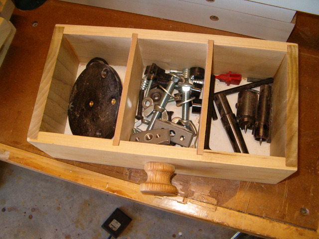

Ed- just snapped 10 photos of my system. With it I can make almost any type of specialized hanging device needed. It uses peg board, but not peg board hooks - so nothing ever comes loose unexpectedly. However all hanging units are movable(re-arrangeable) at will. The photos show tool hangers, a sandpaper organization box, drawers with removable dividers - - There are ten photos, so will take two posts to show.

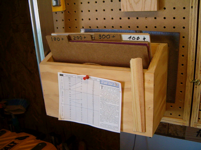

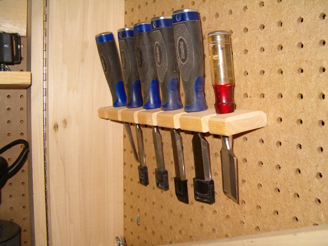

Here are applications other than drawers. BTW I had a box of 100 'L' hooks several years ago. Now I'm down to 8. Time to order more. I didn't show every use of these storage devices, but you get the idea.

I think if you combine the sliding panels with the chisel holder in Chucks picture 1788, you will be able to store those pliers easily.
Cut out a piece of wood to hold the pliers head down, then either use the "L" hooks or just screw them to the sliding panel. Do the cutouts from the back, so that the wood is whole across the front. That way nothing will fall out as you pull the panel out. Make sure that you have a stop piece on the panel, so it can't be pulled out, and you have your handy storage ready to go.
