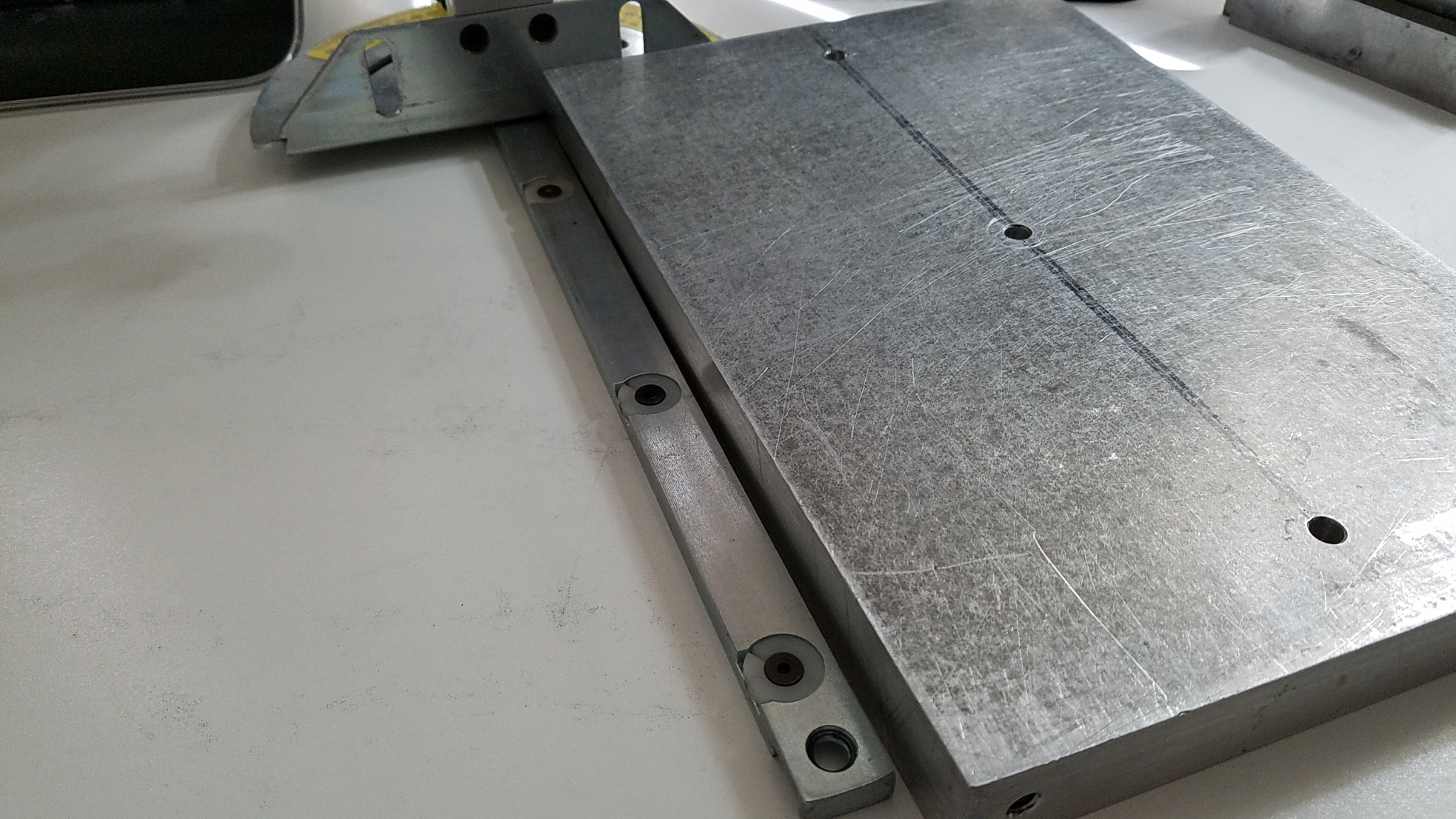

My Miter Gauge, the V120, was manufactured by Incra - a company well known for precision.
I am pleased to hear that you too had a learning experience here on the forum.
BTW - The Incra Miter Gauge squared up real well.
Miter Gauge Squared 002.jpg (1.82 MiB) Viewed 15552 times
The setup gauge that you see here is one of my frequently used gauges. I have two smaller ones that I use predominantly to set or check fences (jointer and rip) for square to the table.

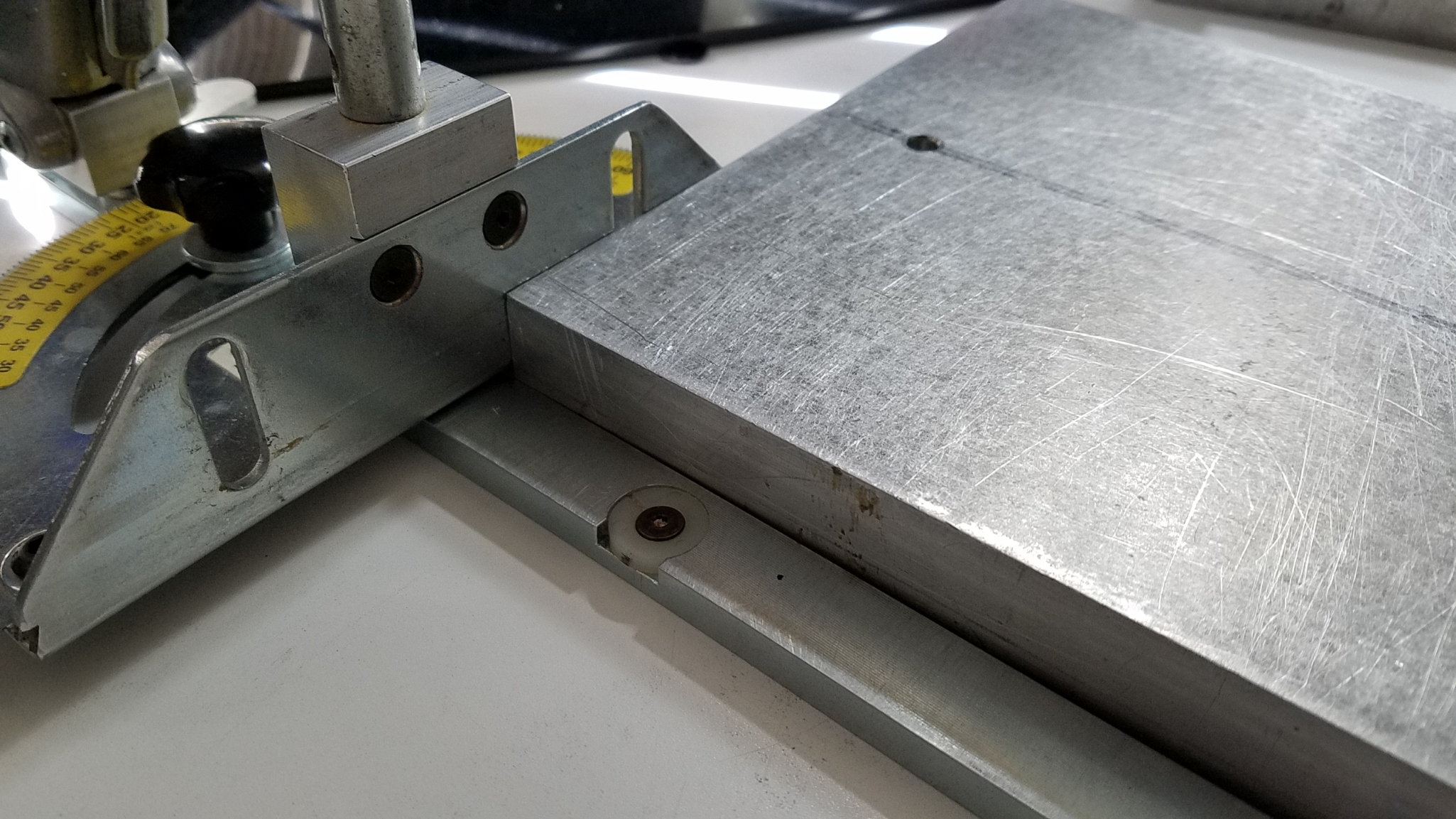

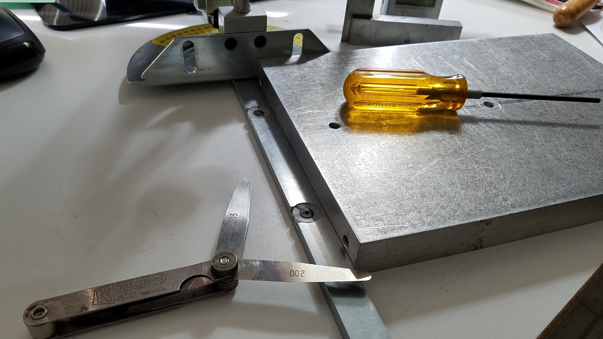

I was quite surprised to see just how "out of square" the V120 could be. This is with the four screws loose and the protractor forced out to its maximum.

I might not be any better off than I was before I discovered the "adjustable thingy", Charlese but I am sure glad that I did. The error was "major minor" and I see no noticeable difference in performance but I do know that the miter gauge is adjusted to within as tight of specifications as can be.
