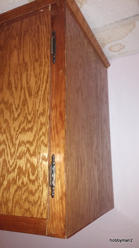

My father in law was good with plywood , never seen him splinter a piece and he used a lot of it, this is a cabinet he made , all of his out side corners were 45 deg , top and bottoms as well as sides. he used metal tracks in side for shelves , they were adjustable .
Just a idea to toss out there .
Hobbyman2
Hobbyman2
Posts: 2673
Location: Ohio
Re: cutting a groove into a plywood edge
Post by Hobbyman2 »
that one is over 25 years old and as strong as the day it was made.
