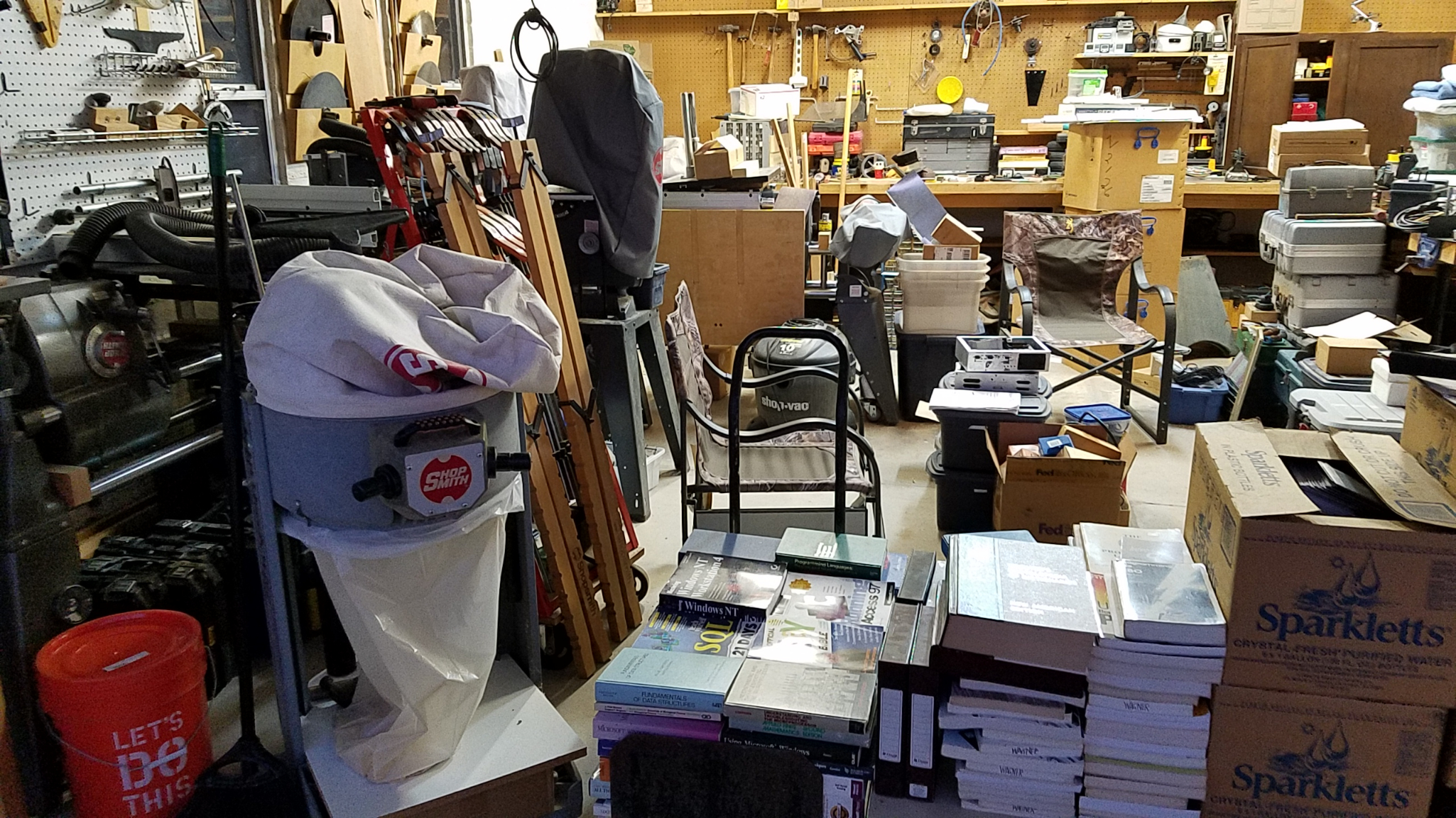

I provide a photo image but I cannot do that right now!
Not A Safe Place to Play 003.jpg (2.41 MiB) Viewed 12690 times
