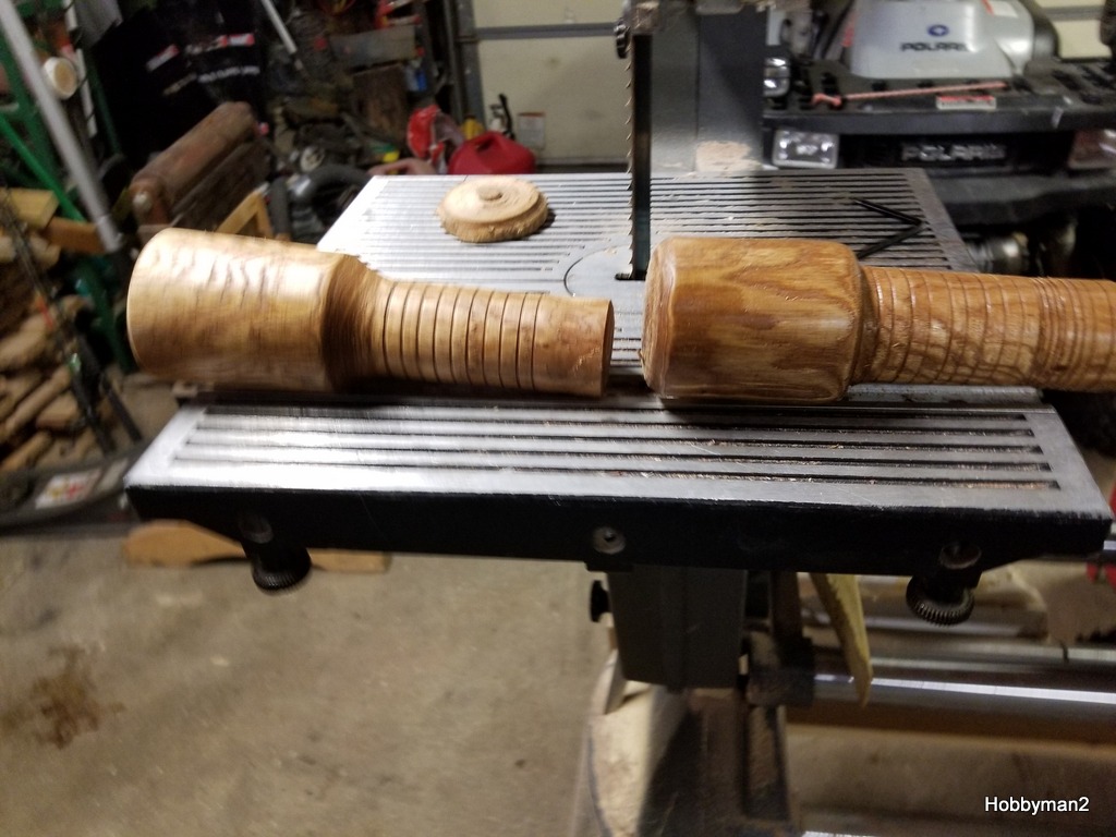

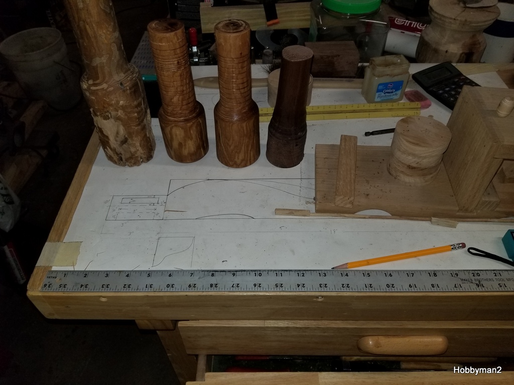

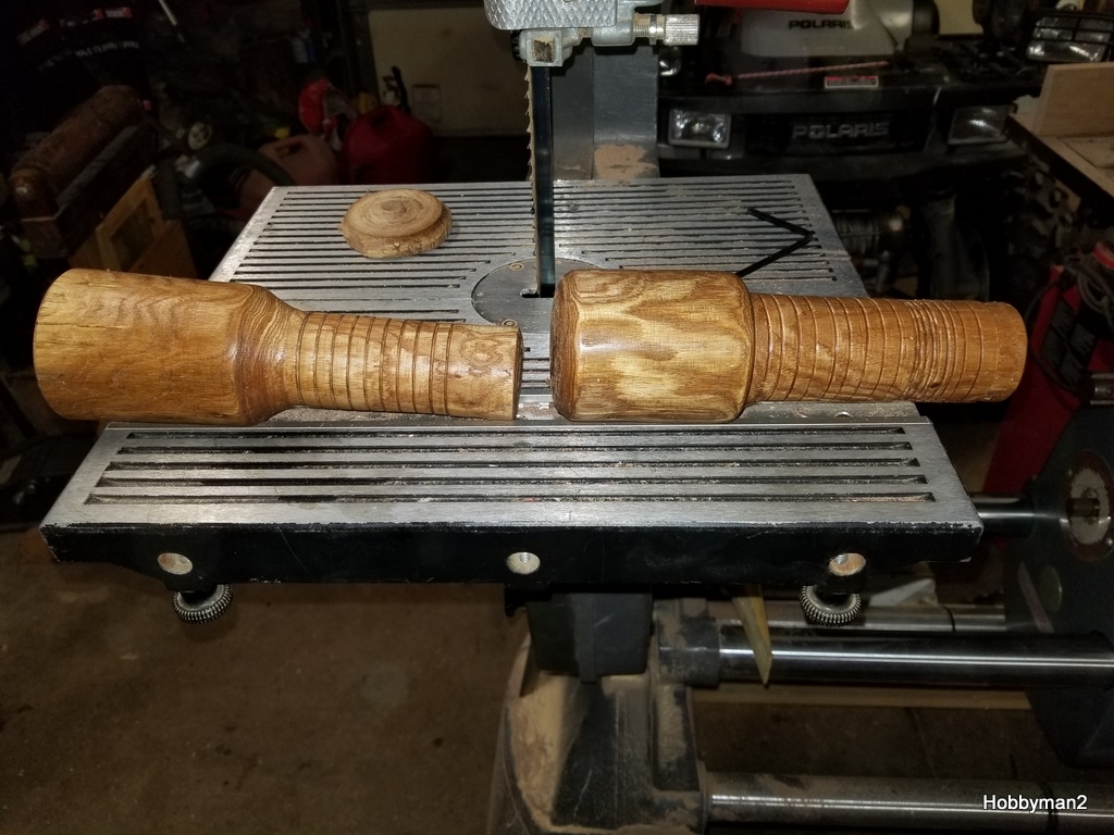

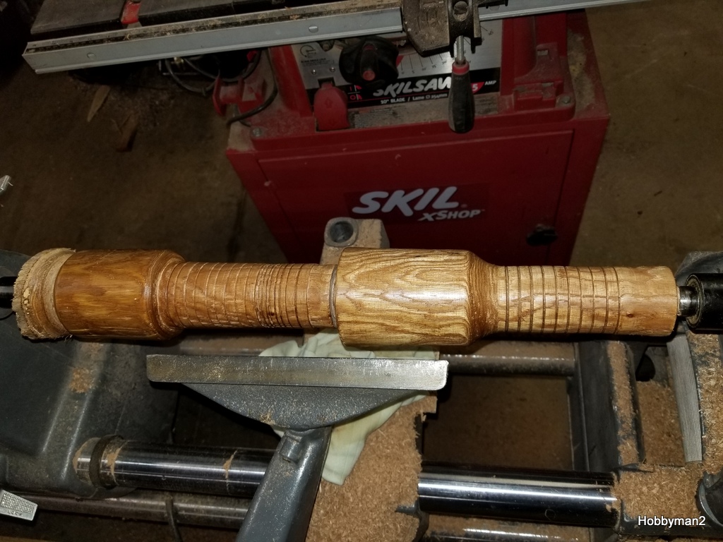

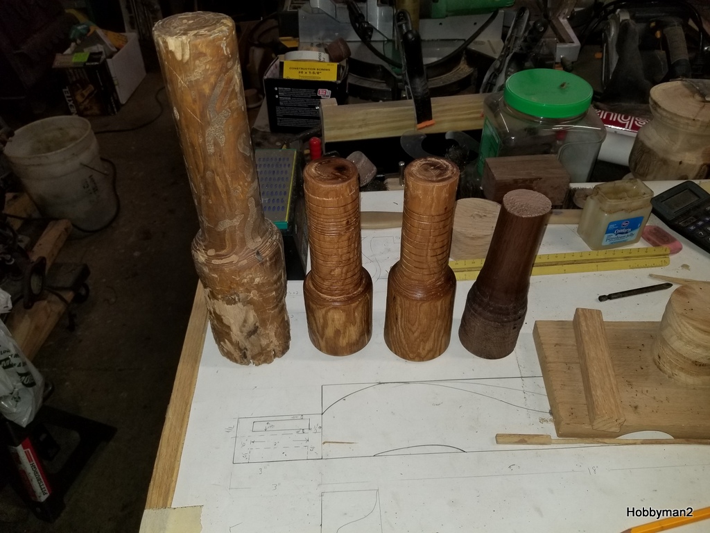

I was thinking about this and realized I needed a couple small ones,,,I braved the high temps of the garage heat ,,, these are from a oak limb I had in the fire wood pile.
The big one,,,I call it the schwack master ,,,, is from a wormy ash limb that was used and abused fro a long time as you can see.
good for any thing that needs a good walop...after close to 10 years it almost worn out ,, the little walnut one is still under development , was going to use it on the leather table.
