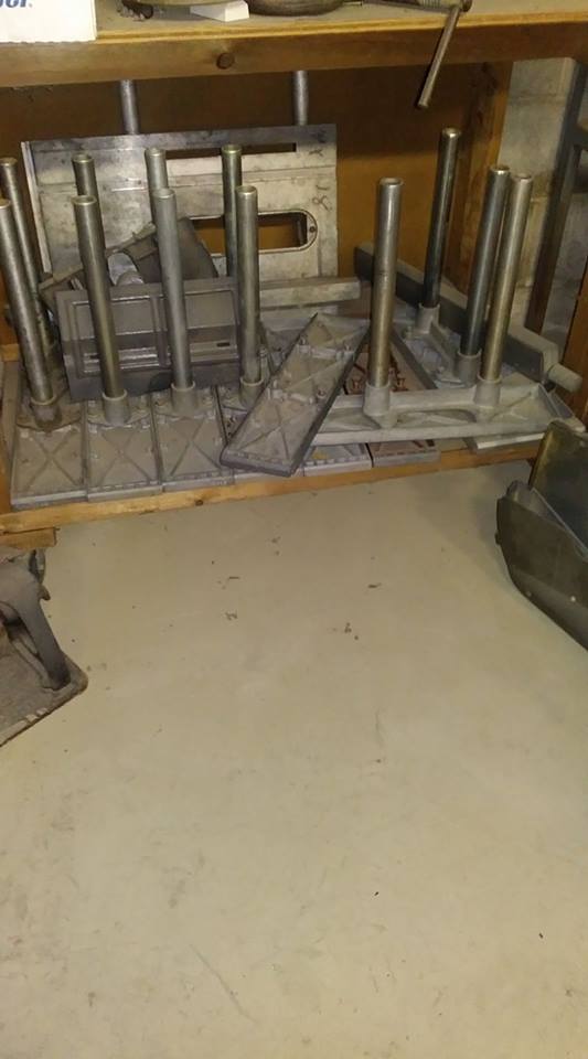

I was looking at a batch of my extension tables today trying to figure out the best way to store them. In the shop I have:
1 for my 510
1 wide one for the older Mark V
8 narrow ones for the older Mark V
2 of the "L" shaped ones for the old Mark VII
1 for the 10-ER
I may have a few more out in the farm shop or the grain bin I use for such stuff.
I don't bother keeping them with a certain SS's except by model. Even then some will interchange.
On the main tables and fences for the older Mark V's I painted parts of them like the bottom of the tables and the ends of the fences to match the SS's they belong with since they were carefully aligned to that particular SS and I wouldn't want to mix them.
I was looking at one older Mark V this week and having thoughts of adding a second carriage to it to mount a second table. I probably should just slap myself and move on :D but I'll look at it some more. It sticks in my head that someone here found a good use for that but I can't recall what or who...

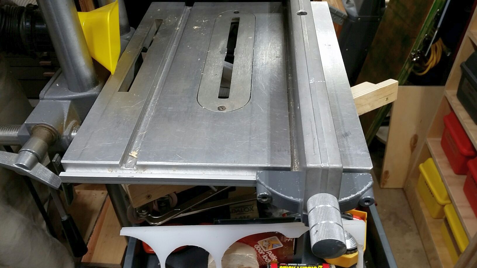

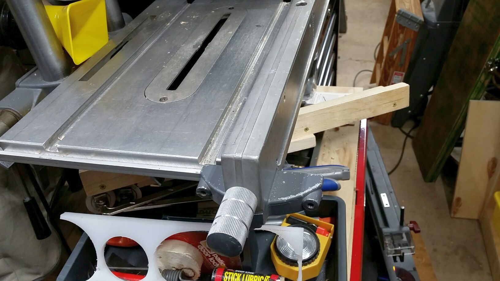

Sorry but I don't have a 500 set up in saw mode in the shop right now. In fact I don't have an extension table here either, off site storage is another story.
So bear with me for these photos with the 500 table in drill press mode but I think you will be able to follow what I'm saying, or at least I hope so.
With the rip fence sitting on the table and in the right most location where the whole fence is with in the limits of the table like this:

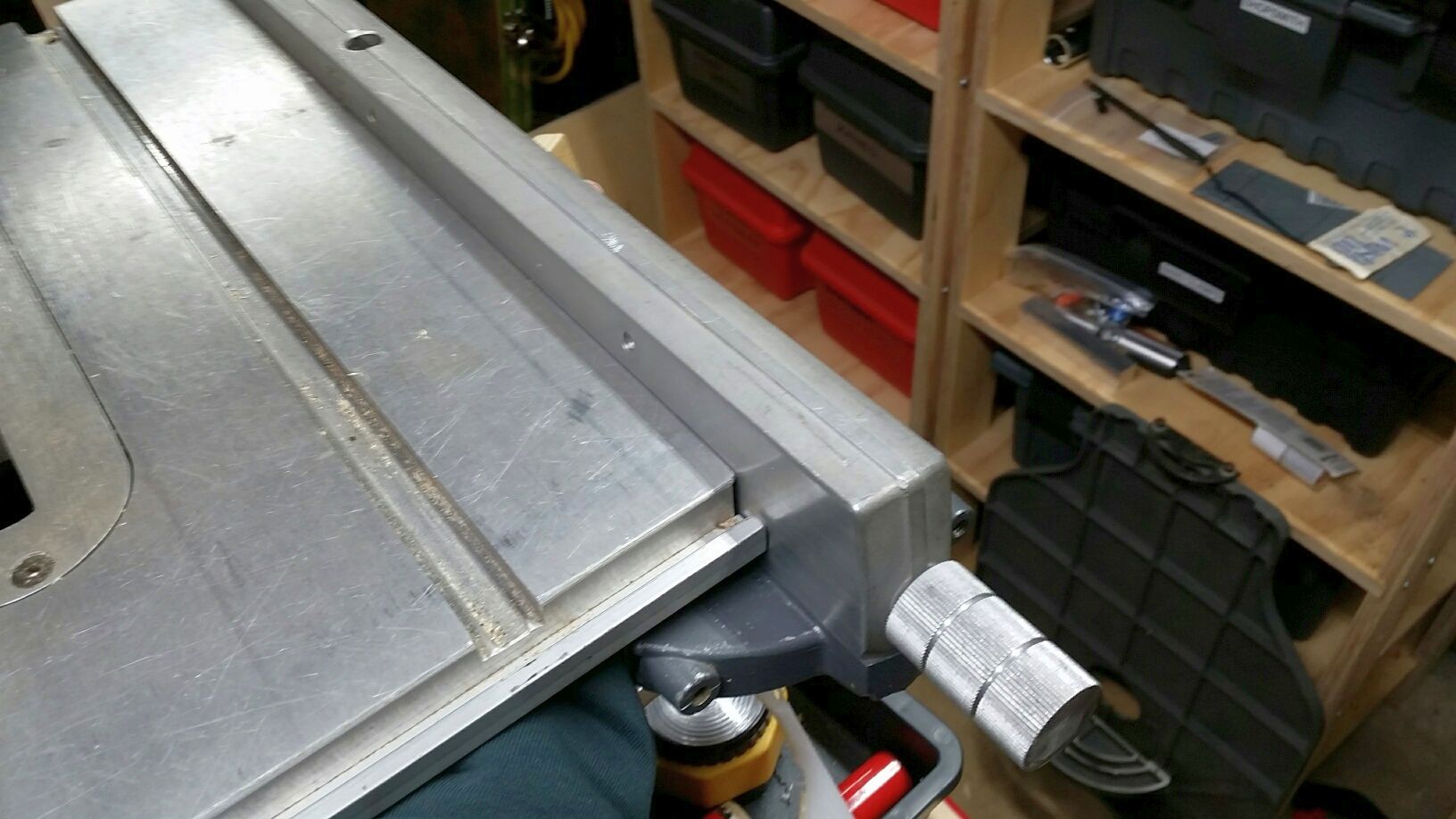

This is a very conservative placement. One might feel brave and slide the fence even farther over so that the right side of the fence is even with the end of the table. I'm not sure if I'd go this far but perhaps some are more inclined to go that extra distance..... so here is a picture in that location:

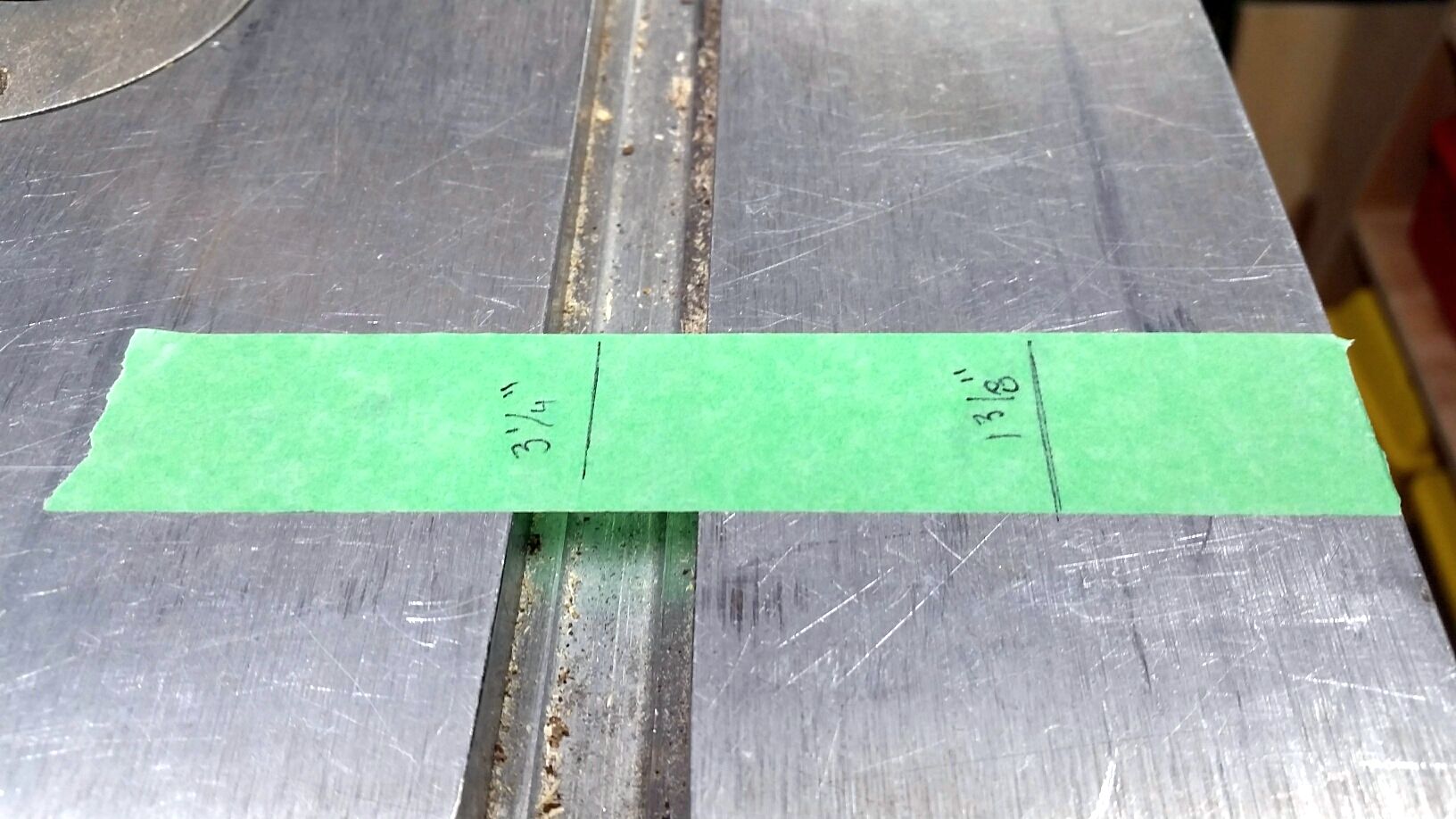

For reference this places the left edge of the fence either 3-1/4" from the edge of the table or 1-3/8". Here is a piece of tape I put down and marked so I could measure those distances.
Now lets look at what would happen if the extension table were lowered and the fence attached to it. Here the left side of the fence is now past the main table give you the extra room by at least the width of the fence.

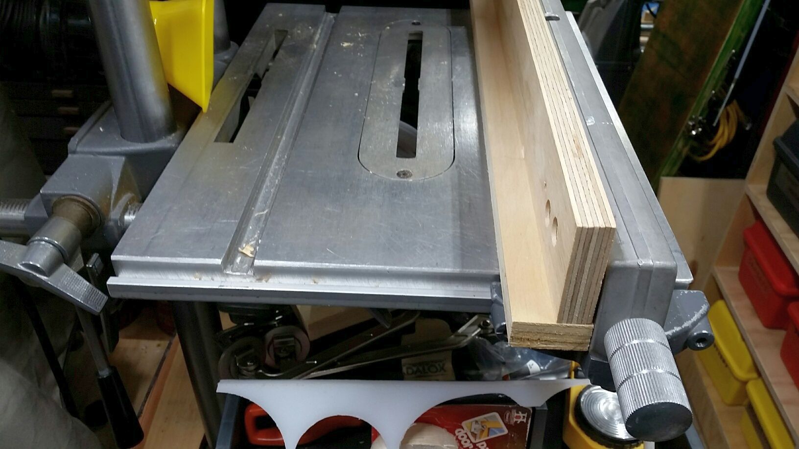

Now the other way to accomplish this would be to keep the main table and the extension table on the same level but add a "L" fence. Now you will have to use your imagination again because I'm showing you the "L" fence I use that allows the use of the upper guard when ripping narrow stock. And yes it is sitting on the main table rather then the extension table where it would be in a real application.
The leg of the "L" would be sized to what you need or want and could be wider then I have and still work for both applications.

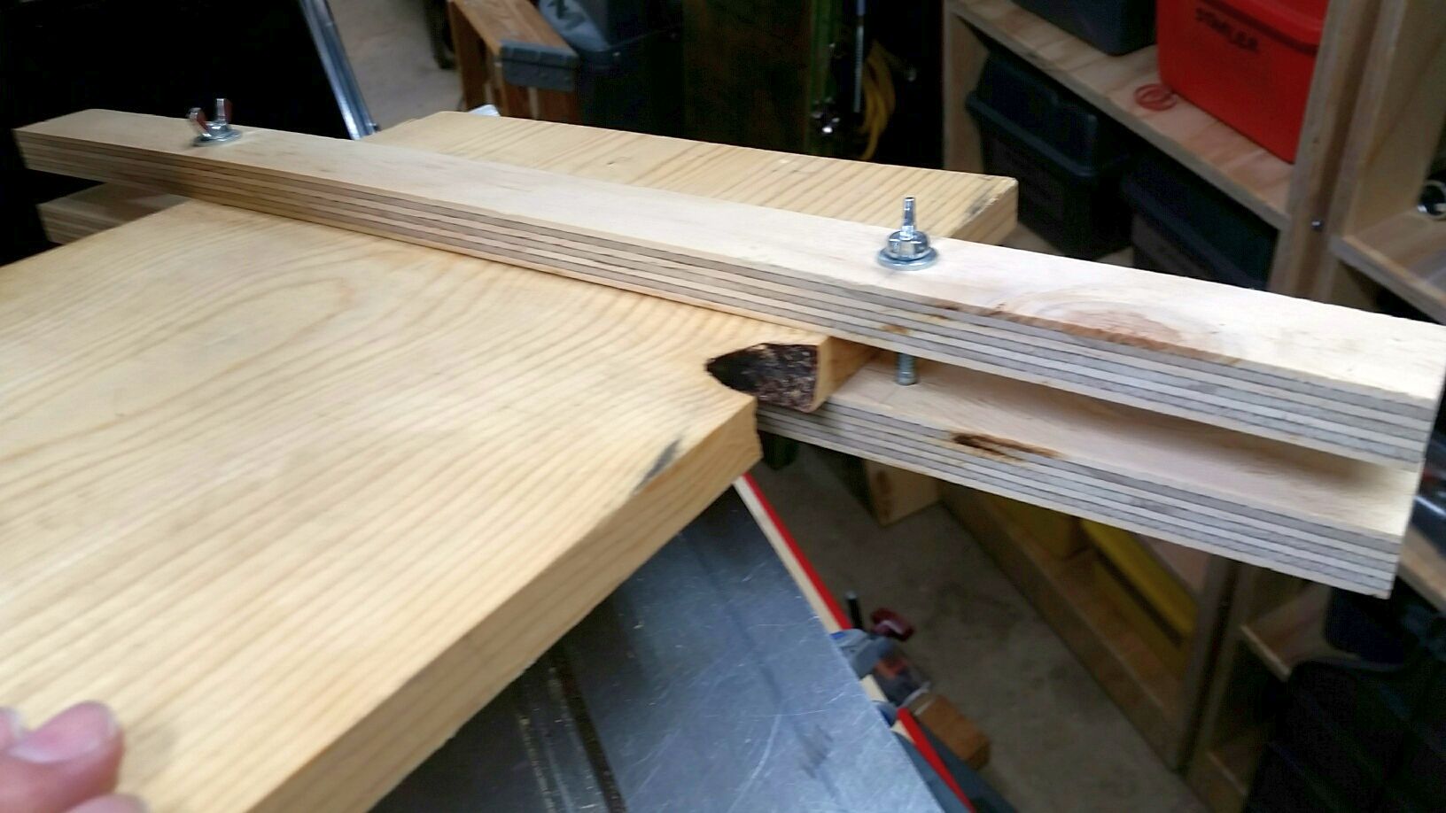

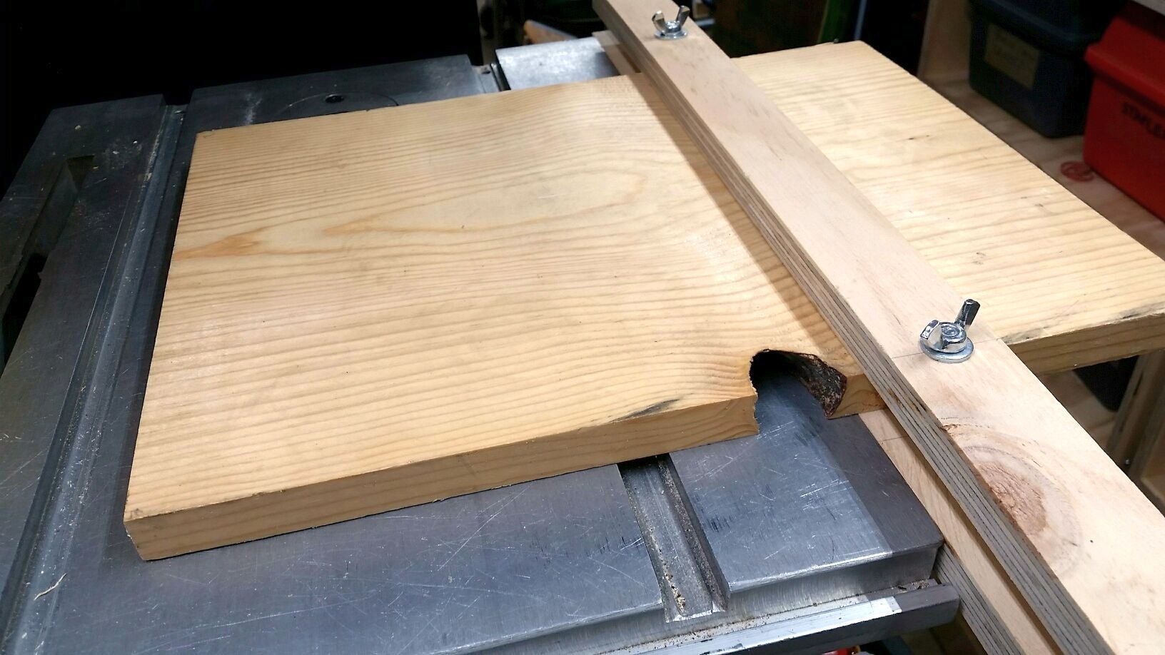

Another jig might work depending on how wide the stock is. It is normally used to get a straight edge on stock but there is no reason why it would not work for other purposes. Note this works on the 500 because the sides of the table are smooth, not so on the 510/520 main table. How accurate would this be? Not sure but this is a jig I made many many years ago and have used a lot of times back when I just had the 500. I believe it is out of the book....
So I hope this helps.

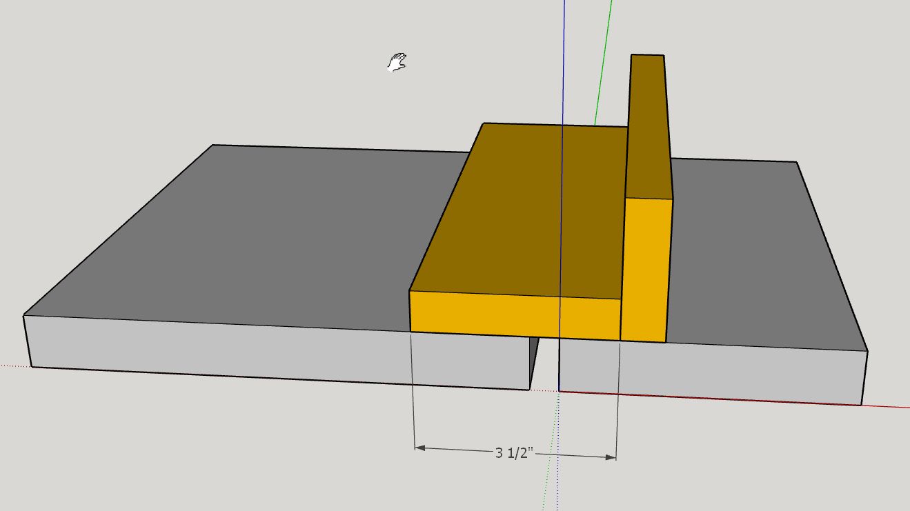

I never ran into this problem because I was one of the people with the two slots but the machines I got for my sons and my other machines are not so lucky.
The fence is not shown but is assumed to be to the right of the "L".
Without having hardware to measure I'm giving a WAG at the "L" fence length of 3-1/2". This should give more then enough room to mount the extension table away from the main table and cover the dead zone. Here is a sketchup look at it:

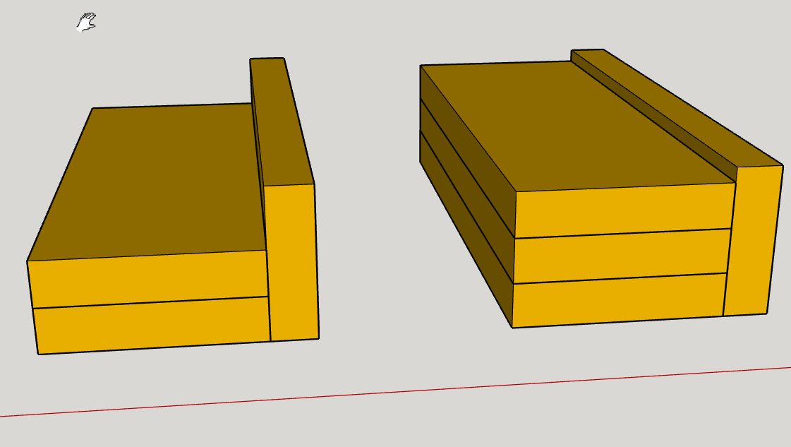

You may need more height and if so one possible way would be to stack some additional pieces on up to the height you need. Here is a look at a double high and a triple high. The design assumes you only need fasteners through the fence but other designs you might want to try could have access from both sides(think of a screw from the far side of the fence in the drawing). Other options exist.

If one mounts the fence at the center of the aux table, the overall width of the "L" (horizontal and vertical parts) needs to be at least 5" (also covers the 1 3/4" width of the aux table area to the left of the fence.
However with the fence centered on the aux table, the fence rail mount overhangs the table edges by about 3/8" and that may interfere with the main table, so maybe 5 3/8" overall is needed.
Maybe a 1x6 with a hook against the main table would take the place of the "L". :D

I'm not seeing this. Perhaps you can "show your work". It might be we are saying pretty much the same thing but I'm allowing for the miter gauge to mount farther to the right then you are or ????
JPG wrote:If one mounts the fence at the center of the aux table, the overall width of the "L" (horizontal and vertical parts) needs to be at least 5" (also covers the 1 3/4" width of the aux table area to the left of the fence.
