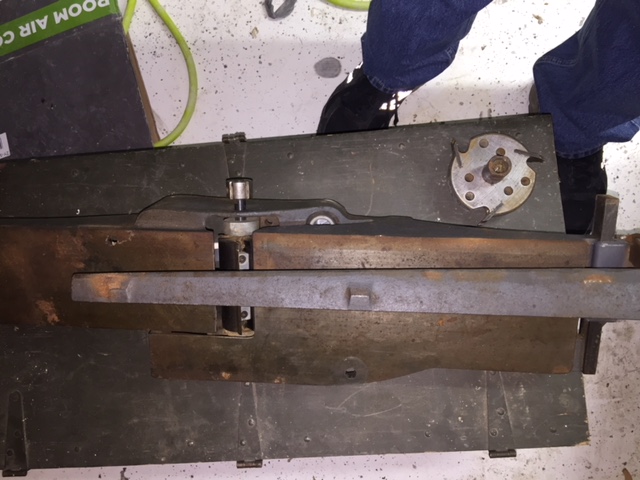

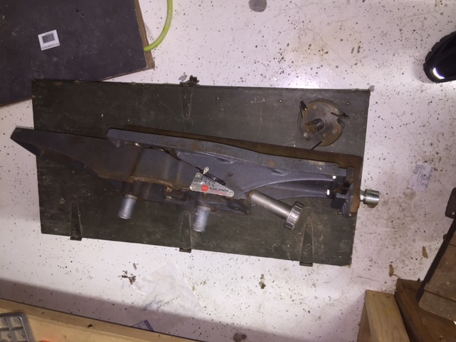

I’m glad you noticed and mentioned the shelf, because I had forgotten that I had placed anything from the Shopsmith on that shelf. That shelf has most of the parts of a lathe replicator along with the guards you noticed which were packaged with the replicator that I purchased. The 12” sanding disc is also on the shelf.
I mistakenly thought I had posted photos of the planer, but had not, so if I have everything right the photos should now be below this text. Hopefully, I did not pay too much for my Mark V, but nonetheless, I believe I will continue to be pleased with my purchase as I paid less than half of the original asking price.
Best regards,
Glenn aka composed
Re: New Here & Have Questions
Posted: Sun Jul 08, 2018 11:59 am
by JPG
Fer the record, that is a jointer, not a planer.
Glad to understand why thee had a lathe duplicator part in the earlier pix. However it should have been attached to a small table that the duplicator slides on.
Nice acquisition!!!.

JPG,
Thanks for your response. Poor typing on my part. I bought I had typed joiner when I actually typed planer. I’m glad that you caught that as it’s a great reminder to me to slow down and read what I’ve typed before sending.
As for the duplicator, I do have the table and I believe several pieces of plexiglass for safety shielding and I’m getting excited about getting to know my Mark V.
Glenn

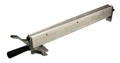

If you have the smaller 500 table and a limited budget but want a simpler less cost approach to an initial safety upgrade consider buying a new style fence for the old style table.
http://www.shopsmith.com/ownersite/cata ... pgrade.htm
Then you can add the feather board kit that works with the later style rip fences to your arsenal of safety.

by dusty
How long is the aluminum extrusion used in the upgraded 500 fence? It looks like a bandsaw fence.
Posted: Sun Jul 08, 2018 7:07 pm
by everettdavis
dusty wrote:How long is the aluminum extrusion used in the upgraded 500 fence? It looks like a bandsaw fence.
I don't know how long, but it would have to be approximately the same as the original 500 fence, since it replaces it.
see the attached PDF about it. Maybe you can extrapolate a length from that. I just don't know how long.
It is definitely not a bandsaw rip fence.
Everett
Mark V Model 500 Rip Fence Upgrade 845363.pdf
(427.35 KiB) Downloaded 2080 times
Posted: Sun Jul 08, 2018 11:23 pm
by edflorence
The length of the extruded aluminum section of the bandsaw fence, not including handle and lock, is approximately 17 inches. The length of the same portion of the upgraded 500 fence is 20 3/8 inches. Apart from the length difference, the fences appear to be identical.
