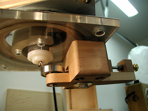

The binding jig is based on a design by luthier Don Williams. You can read more about it at his site. My jig also has a second lazy susan around the router, which is a design by luthier David White. Here's some links to their sites...
http://www.dewguitars.com/BindingJig/Binding%20Jig.htm
http://www.defaoiteguitars.com/page38.htm
The purpose of the second lazy susan is to allow the router to revolve around its center point, which enables you to use a bearing edge guide, rather than a bearing-guided router bit. Here's a photo showing the edge guide that I made...
The white disk around the bit is low friction UHMW plastic. It rides along the top/bottom edges of the guitar.
The idea of the jig is to hold the router vertically aligned as it rides around the guitar. The binding channel is then always cut parallel to the sides of the instrument. This solves the problems that would be encountered guiding a router with its baseplate on the top or bottom of the guitar. Since the top and bottom surfaces of the guitar are convex and sloped, it is very difficult to manually route binding channels and keep them parallel to the sides.

Ingenious!
Tim
Hi Ray! I must add to ingenious - fascinating, beautiful and all the time being very functional. Thanks for the Photos! You get a big ATTA BOY!
