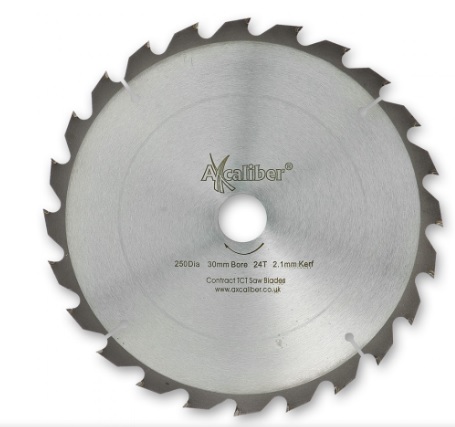

I agree...I don't know if there is much, if any benefit to running the 1 1/4" arbor on a 10" blade versus the 5/8" arbor (at least based on my own limited observations with each arbor size). I believe commercial blades often don't jump up to this larger arbor size until 12" and above here in the US. However, in the UK, I believe they typically run 250mm blades with 30mm arbor sizes (1.18"), so there must be some engineering calculations behind the choice to go to a 1.25/1.18" arbor size on a 10" blade. Maybe these are just over-engineered, but since multiple saw manufacturers appear to have gone this direction, there must be more to it than just pre-existing tooling dimensions.P89DC wrote: Doug Reid claims the first 10" saws came out in the 50s. He's wrong. Delta Unisaw came out around 1939 with a 10" blade and a 5/8 arbor. Unisaw is a commercial saw, not a hobbyist rig.
If you want to constrain your saw blades to 1 1/4" it's not my business. Just don't think you've increased performance by using it. All you've done is limited your choices and upped your cost.
Just curious if any of the esteemed forum members here might know some of the history behind this decision by Shopsmith on the 1-1/4" arbor size and could share it with us. Any recorded or verbal history passed down on Shopsmith's decision here?
