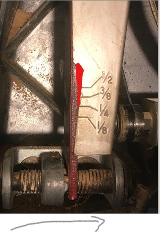

The tension setting looks like 0 tension to me. Which means it is loose.
For the 1/4 " blade you've shown..you want to turn the screw in until the red plate visible bottom aligns with the 1/4" mark...i've tried to draw this on your image.
- setting.jpg (45.79 KiB) Viewed 22535 times

The tension scale should be adjusted so that the left side of the red bar should cross behind the 1/4 mark when a 1/4 inch blade is installed.

There are several suggestions that seem right on so far. First, since the bandsaw was stored unused for quite a while, I suspect you are right that it was stored under tension. Here is a picture of the current tension setting (E) , as well as a measurement of the blade that was on it (F)
$matches[2].
$matches[2]
David
Actually it shows the opposite, it shows zero tension, actually less then zero. It was as I suspected stored correctly with no tension as most SS owners would do. Because you ran it with no tension, the belt behaved as you reported...coming off the wheels etc...to adjust you use the allen wrench to move the red part to intersect the blade width mark. I don't think your tires are that bad, but I do think your blade needs to be replaced. with the proper adjustment and a new blade, I believe you would be fine

I agree that the PO likely had the tension relieved for storage.
Your "E" picture does indeed show no tension, but it also shows no blade mounted.
The tension can only be adjusted/checked with the blade mounted.
Lastly the marks on the scale for the different size blades are to indicate when the red bar spring is deflected sufficient for a given size blade. The
left(in thy pix) edge of the bar is what indicates tension. i.e. the red bar just disappears under the scale at a mark for a given blade size. Gonavy's pix shows the tension somewhere between 1/8 and 1/4. Bainin's pix is correct, but possibly misleading. The red mark in his pix is meant to show where the red bar spring SHOULD be for 1/4" blade tension.
YES running with insufficient tension WILL produce the scenario you initially described.

P.S. The red bar spring left edge should just disappear under the bottom end of the scale. Your "E" pix shows the red bar edge away from the end with NO tension. There is a screw near the top of the 'scale' that allows adjusting for zero tension calibration.

Fantastic. Best news is that we know what got me into this situation.
The Bandsaw was properly stored with Zero tension on the blade.
Operating the saw with no tension, explains two things: the smell of hot rubber, AND the blade jumping and making contact with the round table insert.
