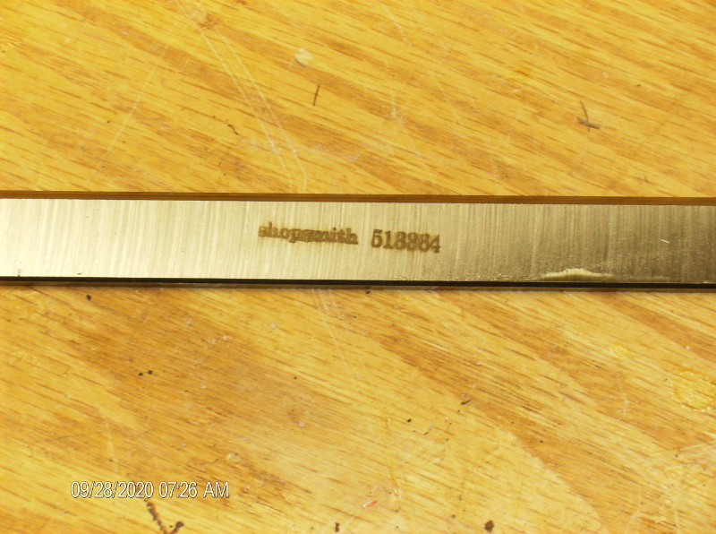

still works?

I do not know why the picture garys posted of the planer knife has the number 513364 and not 505982. 513364 is a newer number and when searching for it you are referred back to P/N 505982 as shown in the online catalog. 513364 being a newer number, my guess is the P/N was changed for the planer knives for some reason but the catalog and parts lists have not been updated so you are referred back to the old part number. Normally when entering an old part number you are referred to the new one.
I did just looked at my extra set of Planer Knives. The knives themselves have the number 513364 etched on to them just like garys but the package has 505982.

chapmanruss wrote:shoedo,
My new set is exactly the same as yours. The package has the 505982 number on it and that is the number I ordered. The knives themselves have that 513364 number etched onto them. Either of those numbers will get you a set of knives from Shopsmith if you order them.

Posted: Mon Sep 28, 2020 6:41 pm
by jsburger
garys wrote:chapmanruss wrote:shoedo,
I just looked at my spare set. I bought the Pro Planer new in early 2003. The date on the tag is Dec 2002. I probably bought the spare set of knives the first time they came on sale after I bought the planer. So 2003 or 2004. They have the same numbers, 505982 on the tube label and 513364 on the knives themselves.

by Mike907
The planer parts diagram also shows the blade part number as 513364, so the other number, 505982, is for a set of three.
