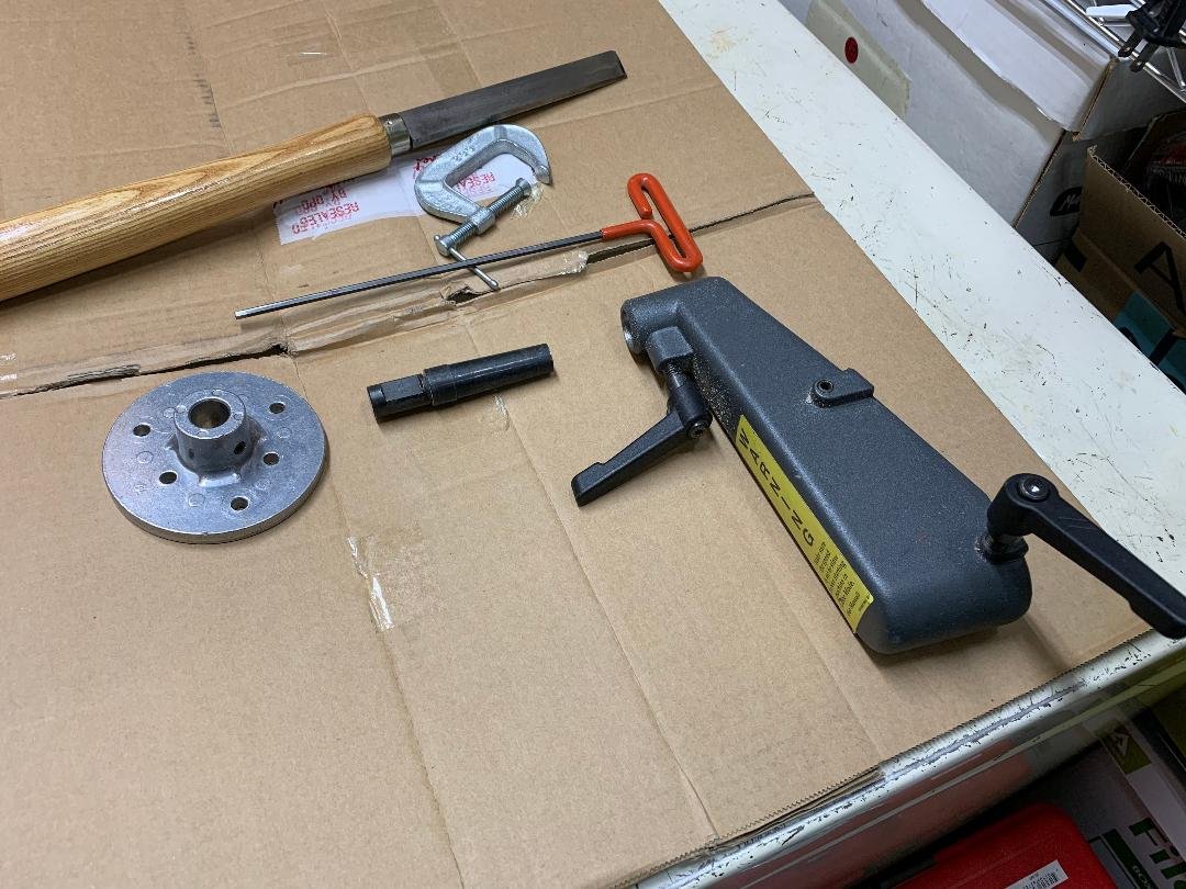

reible wrote: Sat Jan 30, 2021 3:37 pm I have had good luck by using this setup:
You could also just just the arm with a clamp and piece of flat stock below then the c-clamp, or any other options one can think of.
That’s a slick setup, Ed. I’m assuming that’s a faceplate that the skew chisel is clamped to. What did you use for a mounting shaft? My tool-rest arm has a 3/4”bore, and of course my SS faceplates have 5/8” bores.
Re: How to Use Lathe Eccentric Tail Stock Bushing
Exploded view:
Posts: 3814
Aha! Thanks, Ed.
