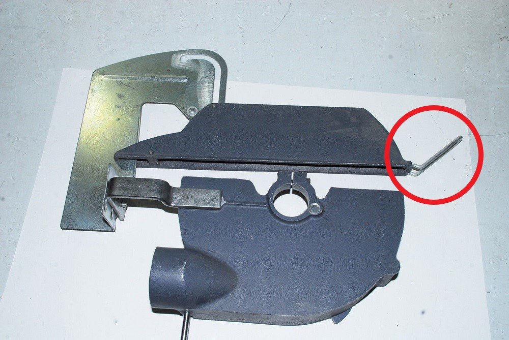

The second Saw Blade Guard is the one shown below.
_
- 505627 Upper and 505628 Lower Saw Blade Guards - shoe.jpg (129.35 KiB) Viewed 1702 times
It is Part Numbers 505627 and 505628 which is an easy to use and attach Saw Blade Guard Set for the Mark 5/V with no drilling or cutting needed. It is less popular because of the cast aluminum upper blade guard not allowing you to see the cut being made. If you do decide to go with this guard set do make sure it has the parts shown in the picture especially the part called the "shoe" which is the heavy wire loop shown circled in red in the picture above that lifts the upper guard up over the material being cut. Without it the upper guard is useless and this is the most common missing part I have seen on these for sale.
