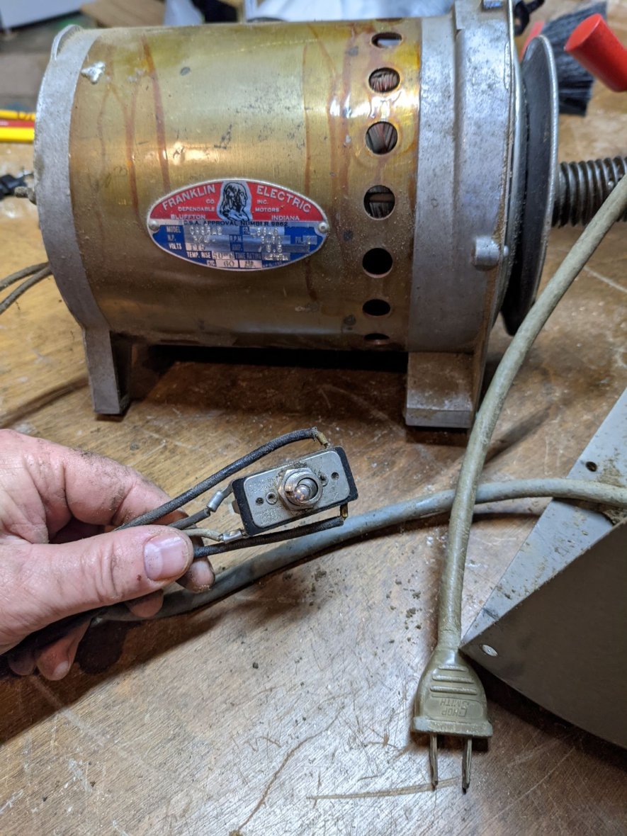

ScotSunnergren wrote: Wed Oct 13, 2021 4:34 pm Yeah... I was surprised that it is not a grounded plug. So that is original. I will see what I can do when I open it up. Are there instructions on where to attach the ground wire inside the headstock if I go get a cord?
Mine is (now) attached to one of the through-bolts that hold the motor together. That's where I found the last little bit of the ground wire from the prior cord that had been cut off. But I discovered that they are through-bolts the hard way. I started unscrewing one and heard a nut on the far end plink down into the motor. That necessitated removing the coil spring from the motor shaft and sliding the inner half of the sheave outward enough to retrieve and reattach the nut. You don't want to do that! ;)
I'm not an electrician but I would expect that directly connected to the motor is best, but anywhere on the case would be fine as well since the motor is electrically connected to the case via the mounting screws.

Does anyone know where I can get the install instructions for this...?
There are no specific instructions that I've ever seen. All of the newer ones connect it directly to the motor chassis, where there is a grounding terminal and screw for that specific purpose. But these won't be on yours if the motor is original. If I were doing mine over I would probably drill and tap for a grounding screw on the motor mounts. (Because if you ever replace the motor this is the vicinity the new ground terminal will be in.) When I did mine I added a screw under the speed control because I was using a generic power cord (aka cut off extension cord) and this was near the other connections.

One caveat re the ground wire: It needs to be the longest wire so IF the strain relief fails and the cord is pulled, the ground wire is the LAST to separate from the appliance(SS).

JPG wrote: Wed Oct 13, 2021 6:39 pm One caveat re the ground wire: It needs to be the longest wire so IF the strain relief fails and the cord is pulled, the ground wire is the LAST to separate from the appliance(SS).
Interesting. I think on the current version the mothership provides the ground is the shortest wire. By quite a bit. They do use insulated terminals on the current carriers, if that is a factor.(?)

Not everyone does the correct thing. Insulated terminals reduces the risk. but ungrounded is a significant risk.
In 1950's grounded tools were just appearing. Most existing homes did not then have grounded receptacles.
Truth be known, the best place to attach the ground wire is the chassis(headstock), then a jumper from the chassis to the motor.
If paranoid, a jumper from the switch(assuming a metal shaft mount) to the shaft to the chassis.
With these jumpers mounting hardware is not depended upon to provide grounding.

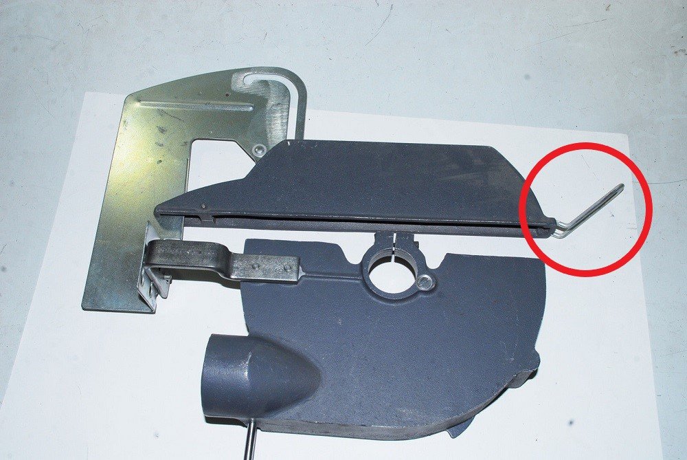

There have been three different Saw Blade Guards made for the Mark 5/V's. The first was an option available early on for the Greenie Mark 5 and can only use up to the 9" blades that were the size that came for use with the early Mark 5. I do not recommend using that version of the Saw Blade Guard plus it is harder to find. Below is a picture of that Saw Blade Guard set.

The second Saw Blade Guard is the one shown below.
505627 Upper and 505628 Lower Saw Blade Guards - shoe.jpg (129.35 KiB) Viewed 1717 times
It is Part Numbers 505627 and 505628 which is an easy to use and attach Saw Blade Guard Set for the Mark 5/V with no drilling or cutting needed. It is less popular because of the cast aluminum upper blade guard not allowing you to see the cut being made. If you do decide to go with this guard set do make sure it has the parts shown in the picture especially the part called the "shoe" which is the heavy wire loop shown circled in red in the picture above that lifts the upper guard up over the material being cut. Without it the upper guard is useless and this is the most common missing part I have seen on these for sale.
The Guard set in the picture in the previous post is the last Saw Blade Guard set that was made for the Mark V Model 500 with the two 2-1/2" dust collection ports upgrade. The has the clear plastic upper guard so you can see the cut being made. It is more work to put on and remove from the Mark 5/V. Installing it on your Mark 5 Greenie will take some drilling and cutting on the Table Tie Bar.

So... this is what I am dealing with electrically...
