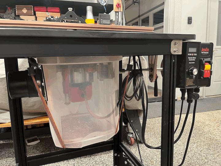

I own a Jessem Pow-R-Tek that looks very similar to the one in your post. I picked mine up in February of 2019 and have used it a lot over the past 4 years. I bought mine as part of a Jessem router table package and have been very happy with both the router and router table. I like the router because it is powerful, the control box is easy to access and the control knob/STOP are big and easy to adjust.
Before springing for the Jessem system I mounted my Dewalt hand-held router with the Shopsmith router table. I found that system very clunky -- it was hard to set the depth of the bit correctly, I didn't have a decent fence, there was no dust collection -- and as a result I avoided using a stationary router. More to the point, my Shopsmith setup always left me a bit queasy and I didn't like using it.
In my new setup I enclosed the router in a plastic storage container which is attached to a 4" port for dust collection. What you can't see is that there is a "hatch" in the bottom of the container that I can empty errant dust from if needed. I haven't had to do that yet -- there is maybe a cup of chips in the bottom of the box after 4 years -- but it is a nice feature to have. I do a lot of pattern routing and have worked for hours on end with neither dust nor overheating problems.
The new Pow-R-Tek with built-in air flow across the motor is probably an improvement over the earlier Pow-R-Teks. Nevertheless, I think you would be completely happy with its predecessor.
