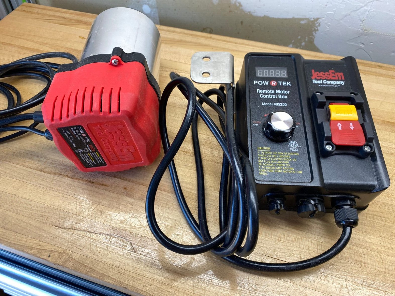

Here is a picture of the one I looked at on eBay. The On/Off switch is different, and there are other visible differences like the provision for cooling air intake hoses on the newer version. This one may share DNA with some others available, but I think is the only one of them with OEM remote speed control. Minimum bid is $185, no takers yet. The similar naming makes it difficult to find applicable reviews.
Old version JessEm table router.jpg (391.04 KiB) Viewed 16011 times

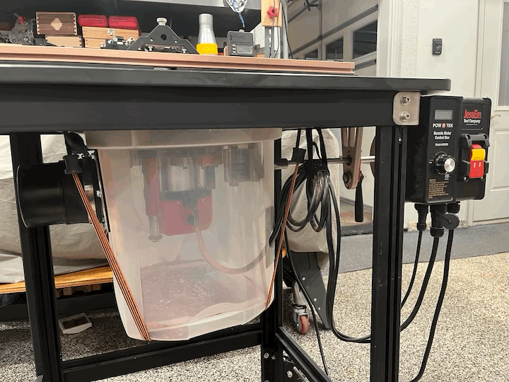

I own a Jessem Pow-R-Tek that looks very similar to the one in your post. I picked mine up in February of 2019 and have used it a lot over the past 4 years. I bought mine as part of a Jessem router table package and have been very happy with both the router and router table. I like the router because it is powerful, the control box is easy to access and the control knob/STOP are big and easy to adjust.
Before springing for the Jessem system I mounted my Dewalt hand-held router with the Shopsmith router table. I found that system very clunky -- it was hard to set the depth of the bit correctly, I didn't have a decent fence, there was no dust collection -- and as a result I avoided using a stationary router. More to the point, my Shopsmith setup always left me a bit queasy and I didn't like using it.
In my new setup I enclosed the router in a plastic storage container which is attached to a 4" port for dust collection. What you can't see is that there is a "hatch" in the bottom of the container that I can empty errant dust from if needed. I haven't had to do that yet -- there is maybe a cup of chips in the bottom of the box after 4 years -- but it is a nice feature to have. I do a lot of pattern routing and have worked for hours on end with neither dust nor overheating problems.
The new Pow-R-Tek with built-in air flow across the motor is probably an improvement over the earlier Pow-R-Teks. Nevertheless, I think you would be completely happy with its predecessor.

Same vintage Pow-R-Tek router as in DLB's picture
