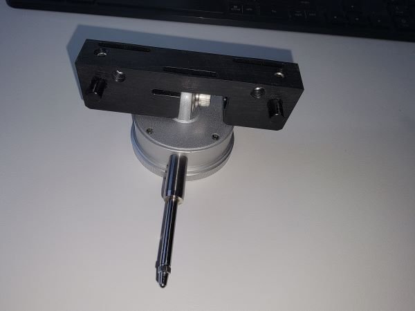

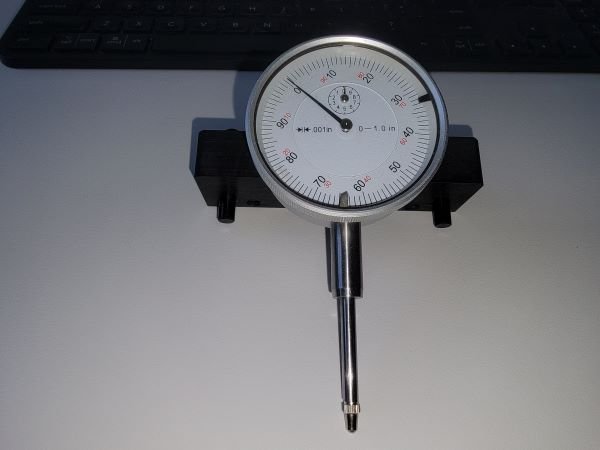

I really do not see the need to "micro adjust" for saw cuts BUT if there is a need, why not use a dial indicator mounted in the miter track?

dusty wrote: Mon Feb 06, 2023 1:58 pm I really do not see the need to "micro adjust" for saw cuts BUT if there is a need, why not use a dial indicator mounted in the miter track?
I tried this when you posed the question earlier but found that I could not reliably position the fence (520) better than +/- 0.003" of an arbitrary target on the indicator. Contrasting that with the quill feed adjust, which I found that I could reliably position within +/- 0.001" of target. And I would guess the 520 to be an order of magnitude better than 500. I have always used the quill feed for micro-adjust of a cut position, a habit I formed in my pre-500 days because that fence is somewhat harder to lock at a precise distance from the blade. I have no reason to suggest that +/- 0.003" isn't good enough, it is just my observation that it is not as good as the quill method.
- David
Re: ZCI and the quill
DLB wrote: Mon Feb 06, 2023 3:21 pm
- David
Maybe I don't understand the intended procedure here. The object is to get a precisely located cut. To do that I would think the fence was located close- very close to the intended measurement and then locked in place. Then the micro adjust (of the blade) would take place.
My problem here is that I do not do woodworking that requires the saw blade to be so precisely located. Within +/- .003" is in my mind "micro adjusted". How close do you want to get.
