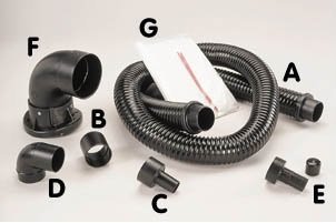

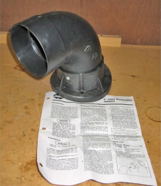

P.S. It sucks that Shopsmith stopped selling that manifold replacement for the DC-3300 that would give you a 4" connection instead.

RFGuy wrote: Wed Jan 21, 2026 6:29 am P.S. It sucks that Shopsmith stopped selling that manifold replacement for the DC-3300 that would give you a 4" connection instead.
The new management might bring it back if they got enough requests

Agreed. Not sure the quantities would be enough, but I assume many DC-6000 owners are already using 4" equipment with them based on past posts. It would surely buy a lot of goodwill if the new company, once they get on their feet, could look into bringing certain items like this to market for the Shopsmith community. Accessories should be much easier to bring back or invent new, whereas new SPT's are much more difficult. Yeah, the filter bag is one of the biggest Achilles heels with the DC-3300 or DC-6000. This is why many woodworkers call these dust pumps, not dust collectors, i.e. because they spew more dust particulates back into the air through the bag exhaust than they collect. At one time, I found the following information on the Shopsmith website and recorded it in a past forum post. So, I will reiterate it here for everyone. Based on similar dust collector filter bags on the market, I do believe these numbers are reasonable. Also, this is why ANY HEPA filter excels in comparison because most HEPA filter cartridges filter down to 0.3µm. Below is the link with more info on where I got this Shopsmith information:
