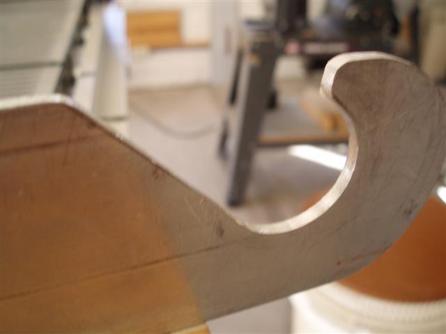

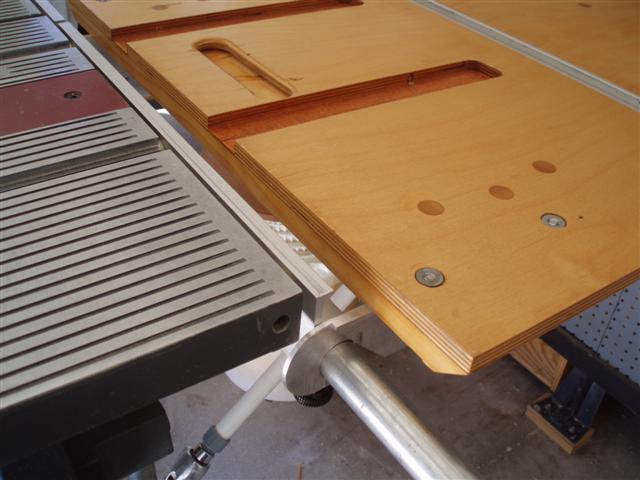

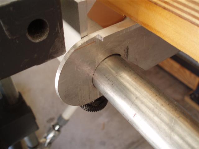

I felt that one of the reasons for why I had this problem was because I had not installed the out feed table. I had a personal excuse for that but I've eliminated that excuse from discussion.
[ATTACH]6238[/ATTACH]
[ATTACH]6239[/ATTACH]
[ATTACH]6240[/ATTACH]
Now the hooks (used to be holes) just drop down on the tube that runs through the rail (outfeed side) of the Main Table.
I'll use this for a short while and then I am going to rebuild my outfeed table. It needs to be wider so that it will span two floating tables and the main table. I am thinking about making it just a bit shallower (infeed to outfeed dimension).
Comments will be greatly appreciated (especially regarding size).

It does not clamp to the fence. The hook is the only thing working other than gravity.
The pictures associated with post #3 in the following thread will (I think) answer all your other questions. No, there is one other. Those are not t-nuts they are threaded inserts (almost the same thing).
