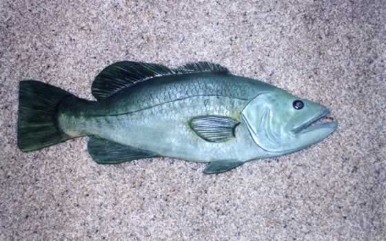

I got a book on nautical caving a few months back. I plan to do some projects this spring. Here is a basswood Bass.
[ATTACH]7387[/ATTACH]

Nice fish ! Looks good enough to eat.

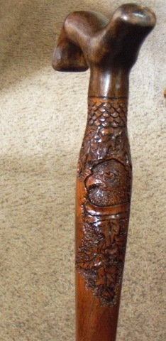

This is a cane I made for my self when I had my hip replacment. It is all wallnut.
[ATTACH]7424[/ATTACH]
cane -santa 003.jpg (89.94 KiB) Viewed 4017 times

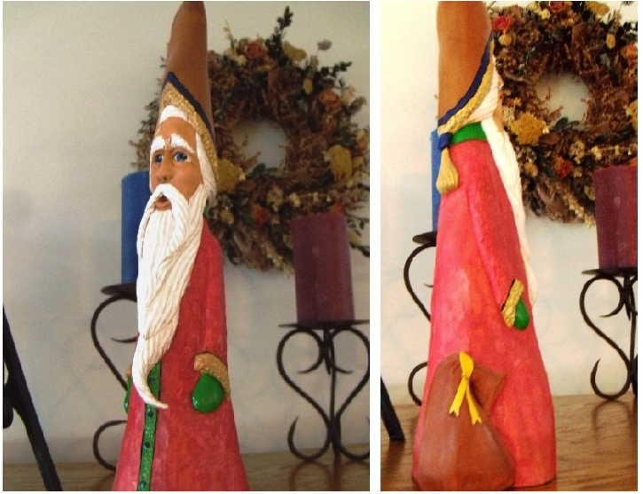

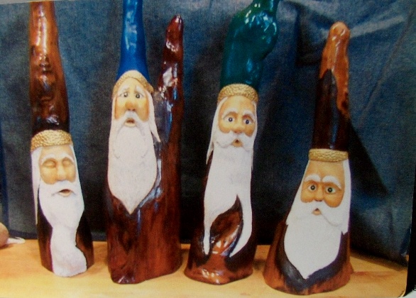

These are some cypress Santa’s I made four my family last Christmas.
[ATTACH]7425[/ATTACH]
[ATTACH]7426[/ATTACH]
Copy of carvings Jan 6 003.jpg (152.28 KiB) Viewed 4017 times
santa ss.jpg (230.07 KiB) Viewed 4021 times

Talent and imagination. A sweet combination. Great work CV !!

Absolutley gorgeous work. I bow to you. I'm limited in turning because of the shopsmith bed length. I'm trying to use my imagination but i found I'k having trouble finding cane parts. i found a few pieces in Lee Valley but I need a source for 2 inch acrylic knobs or balls. thanks and i envy the cane and ships port anchor skid. Stan

You may want to take a look at treelineusa.com the offer a number of cane part. I had to use a friend’s lathe on some canes. But, for the most part cane length is going to be 34” or less. I make most of my shafts 32” to 33” I make up length with the handle. I use 3/8 to5/8 all thread to joining the handle and the shaft. That makes the cane 35” to 37” then I cut it down to fit the most people. This method I use to measure for canes.
Method Measure the person who will be using the cane.
a. Make sure that the user is wearing the shoes he most often wears when walking with a cane.
b. Ask the user to stand upright with his arms at his side in a relaxed manner with a slight bend at the elbow.
c. Measure the distance from the floor to the middle of the wrist joint using a yardstick or tape measure. Keep in mind that if the measurement is more than an even number, round up to the nearest 1/2 inch, ie: 31", 31-1/2", 32" etc.
(**In order to achieve accuracy, someone other than the person being measured must read the yardstick or tape measure.)

Great job. People probally think you catch it instead of carved it..
