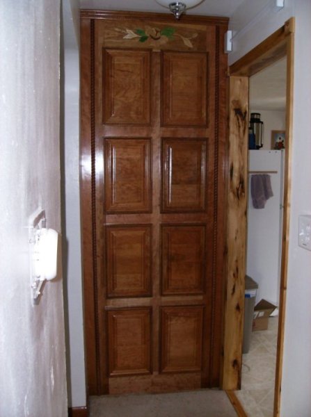

My Wife and I built this cabinet in November, 2010. It is cherry with no stain. It got just two coats of urethane varnish to finish it. It is now 4 months old, and has aged from a quite light color when first finished 4 months ago to this color.
http://www.shopsmith.net/forums/attachm ... 1299076802
- cherrysmall.jpg (73.35 KiB) Viewed 4406 times
