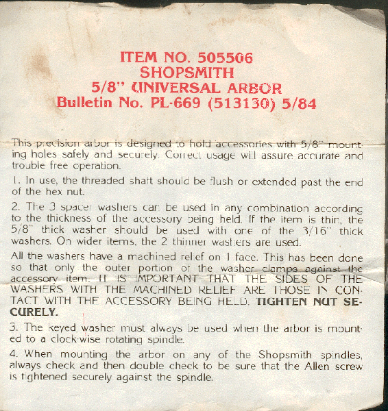

SDSSmith wrote:If you get one without the keyed/tongue washer, Shopsmith sells them. They are pricey but very important if the arbor is to be mounted on one of the auxilary shafts on the left side of the headstock. Item 501454, $6.37 the last time I ordered one.
The Ultimate Authority:
(keyed washer)[ATTACH]8941[/ATTACH]
arbor day sm txt.gif (243.24 KiB) Viewed 1615 times
