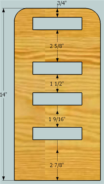

To route or not to route?
that is the question.. For my footboard project, I've got this piece to make that will be the most challenging (and it isn't really that much of a challenge) :
[ATTACH]9175[/ATTACH]
The hardest part will be the holes in the board.. I could drill some pilot holes near the edge of each hole area and use a hand-held jigsaw to go around the perimeter. I'd like these to look nice and I may not get a nice straight edge if I use the jigsaw.. So, a router came to mind. I could make a jig to run the router in an elongated circle (the diagram shows square corners but they could easily be rounded -- no biggie) which would have the benefit of a nice straight edge but will require more work up-front for the jig.. If I'm going to be making 5 or more of these then a jig seems to make a bit more sense.
Comments?
P.S. If I want to make a jig for doing ovals or circles with a router, whats the best approach? Is it using something like MDF (or ply?) and just cutting out a large hole that will allow the router to run around the smaller hole without going out of bounds?
Comments?

My favorite would be the OPR with stops clamped on the fence. Not having that accessory....
- My next favorite would be a pattern piece made from MDF with over-sized slots, then use a guide bushing on the router. The pattern can be stuck onto the workpiece with double sided carpet tape.
- My next method would be to use a router table with stops on the fence. This would require 4 movements of the fence with your present dimensions.
IMO rounded tenons would look cool on the foot boards.

Get a set of guide bushings that come with a centering cone. I don't know off hand how much the difference (width) is between the outside of a bushing and the bit inside, but ask at Rockler they'll know the bits and the sizes of bushings. If they don't know - Ed (reible) does.
Good news!--The bushings are made for your router plate. There's usually no measuring needed, for most operations, If I remember right it's usually a standard difference like 1/8". It is most important to center the bit!
Hi,
Making a template and using guide bushings would be my way of do this. I'd make one template then use that to make another template with all the cut outs. Add a way to make sure it is positioned the same way on the work piece and a way to clamp it on (could be double sided tape even). And you will be making them in no time at all.
I posted a table with guide bushings and bit sizes but I'll have to look it up. It also has a tutorial on some of this jig building and template bushings. I'll try to find it yet tonight.
