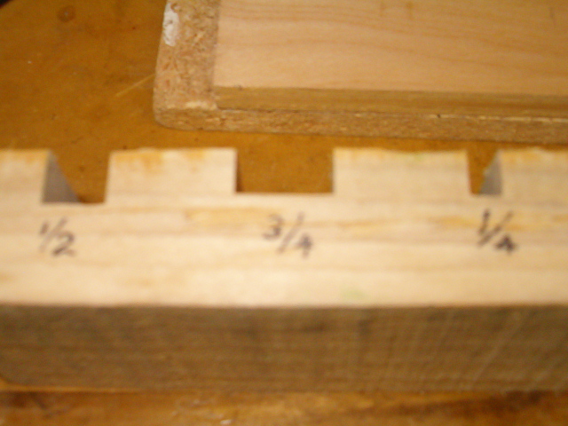

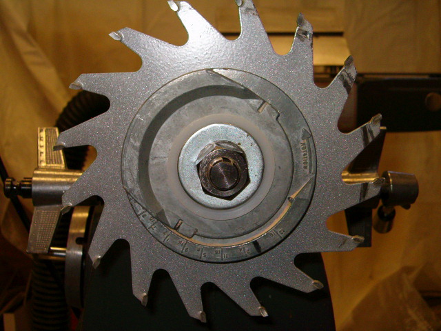

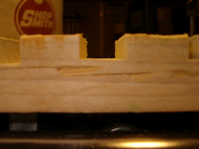

6" does me just fine! Maybe I'm not a good example though, since I use a wobble. Here's results from my wobble. To tell the truth - I've never needed a dado or groove deeper than 3/4".
[ATTACH]9251[/ATTACH]
[ATTACH]9252[/ATTACH]
[ATTACH]9253[/ATTACH]

8" Tenryu, here. Only because the store didn't have a 6". IMO, 6" is plenty.
