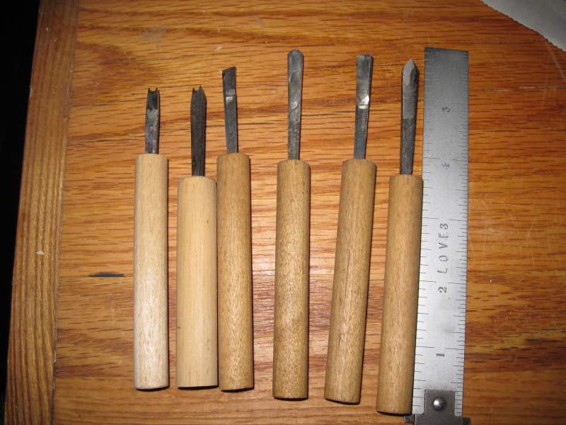

Here are a few homemade lathe chisels.
[ATTACH]9868[/ATTACH]
These were made from cut nails and work well for detailing miniature turnings or pens, etc. They were ground on the sanding disk, taking care not to overheat the edges, and then mounted in 1/2" or 5/8" dowels. The two beading cutters were first drilled, as I recall with a 1/8" drill bit, and then ground. One also could use old allen wrenches instead of the cut nails.

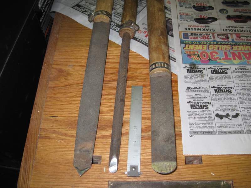

These were ground from old files and are quite large and attached to long oak handles and secured with band clamps. They work, but the bodies of the tools haven't been ground, so they are hard on the tool rest. Since files are brittle and could break easily, I'd not be inclined to use them where catches while turning are possible, nor are they appropriate for the inexperienced turner.

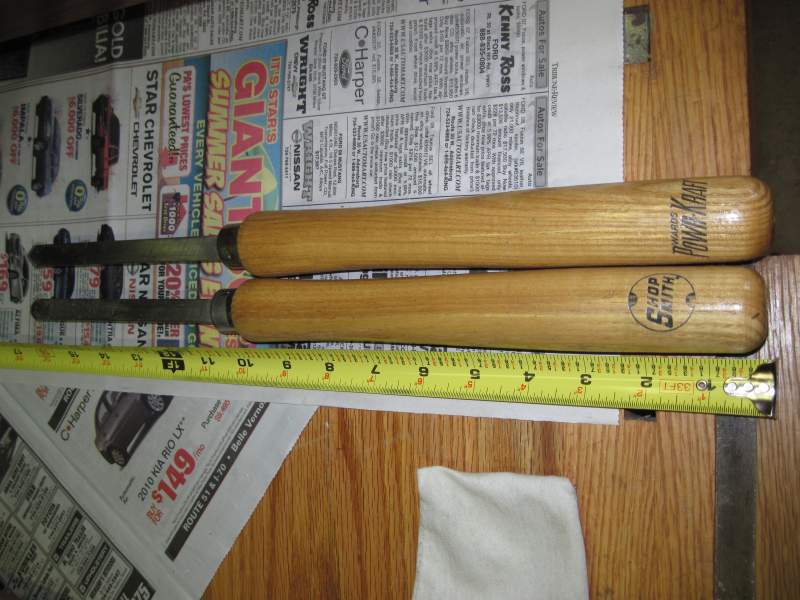

The the Buck 1/2" round chisel sounds like a lathe turning chisel, but the others are likely carving chisels and could get you in trouble if used for turning. I've attached a picture of the Shopsmith 1/2" round chisel which is about 16" in length. So, if yours doesn't look like this one, perhaps it's not a lathe chisel.Thanks for the additional info. I did not receive any chisels with this really used '56 SS. I do have a 12" long wooden handled Buck Brothers 1/2-round chisel, and a set of Bucks with hard plastic handles (V, Lg & Sml U, Bent shank U, Skew and straight) chisels.
[ATTACH]9870[/ATTACH]
The Shopsmith chisels I got with my Mark V back in 1980 were made by the Great Neck tool company. In addition to supplying Shopsmith, they sold them under the Buck Brothers label and through Montgomery Wards and perhaps others as well. The newer Shopsmith tools have a different handle design and I don't have one to compare with the older tools, so I don't know if they're currently coming from Great Neck or not.
Someone mentioned earlier that Shopsmith doesn't specify what type of steel is used in their lathe chisels. But, I see that the current Great Neck lathe tools are labeled as being made of "high carbon tool steel," and since they look like my old Shopsmith tools, I'd guess the old ones are the same metal.

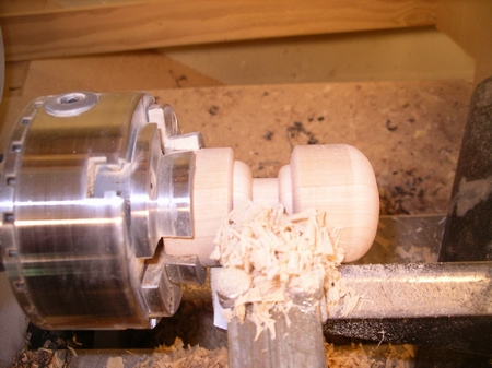

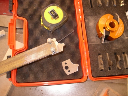

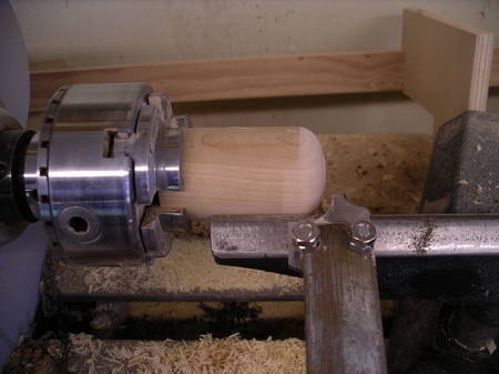

I need some turned finials for a table I'm making. It would be nice if they were identical so I thought I might try using shaper knives. I happened to have about three feet of brass bar in the shop so I drilled it and bolted the cutters on and guess what? It worked like a charm. I may not use these particular cutters but the idea does work. It makes me think I may have made the round corners on my kitchen crown moldings the hard way, I think you can probably use the same cutters on the lathe to make corners that you use in the shaper to make the straight parts. (Round outside corners on crown molding is a characteristic of antique French country furniture)

- IMGP0001.JPG (143.37 KiB) Viewed 5013 times
- IMGP0002.JPG (119.88 KiB) Viewed 4977 times
- IMGP0003.JPG (126.86 KiB) Viewed 4953 times
