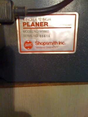

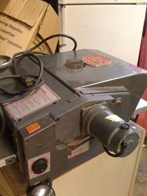

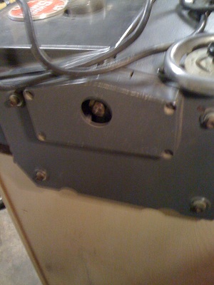

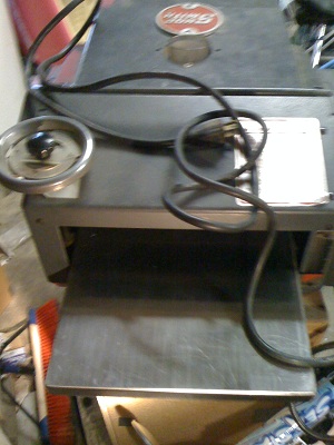

Here are the pix. My dad got me interested in wood when I was a child. We built a house of 2x4's that we got from the saw mill. The were 18-36 inches in length and we laid them like bricks. Elmers glue as mortor and 16 penny nails. We did the whole 2nd floor like that. We then hand hewn(hope I spelt that right) the beams for the 3rd floor. So I have used an Ads and other tools growing up. Just a little brief as to why I have a need to work with wood. I have 7 years till I retire and I need to start building my shop and tool collection while I have a steady income. I watch everything I can find on woodworking and I want my work to be good, with folks like you helping I don't have a chance to mess up.. I didnt take a picture of the hand crank that I have but it is the same size as the motor mount.
Pix helped greatly! If the 'extra' crank included the housing/plate shaped like the one on the feed motor, it definitely be an extra manual feed crank.
It appears there is a connector hub on the power input shaft.(not easy to determine for sure)
You should have the two way tube clamps and wing bolts that secure it to the Mark 5/V. If not, a substitute may be easily made.
Notice the indentations along the bottom edge. These are where it sits on ss way tubes.
BTW: Make sure that $100 ss in NOT a model 10(10E 10ER). Tube spacing is different, and the motors were <= 1/2 hp.
