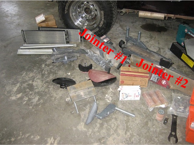

Well the F-350 came back with ShopSmith cargo!
It was not exactly as described but, it usually never is. All of the major pieces were there, scattered in three different locations (storage shed, garage and house), as for minor pieces… I still have to sort that out.
The Mark V model 510 that was purchased “5-6 year ago” has a 1998 date stamp! “Hardly ever used” I believe, but stored roughly. The unit and accessories has little rust, but lots of cosmetic dings and scratches from storage. Some of the plastic pieces (looks like dust collection connections) are cracked or broken, but should be easily replaced.
He wanted $1500, I offered $1250 (I should have offered less but…) he countered with $1300 and it went into the truck!
Let me know your honest opinions, like “you paid how much for that!”
I am now the proud owner of a ShopSmith Mark V Model 510, with Band saw, Scroll saw, belt sander, jointer, shaper, and a second jointer that I have yet to recognize.

I think you paid an excellent price for your SS. Right off the bat you might consider selling one of the 4" jointers. I wonder why he has two. I can see that you might want to add to your saw blade collection of one right now :). I would recommend buying arbors too, because it's so much more convenient when changing blades if they're on their own arbor. I see that you got some video tapes with it. Do you have a VCR :eek: ?
Other recommendations I would make is to find the SS manual and "Power Tool Woodworking for Everyone" because it is appropriate for the SS and has lots of plans for jigs to build that make woodworking safer, quicker and easier (what else are jigs for anyway?). Also, before you try to use your machine, clean, lube and align it.
I think the only way you will regret the price you paid is if you don't use it :(. I'm sad when I hear that someone bought a SS and never or rarely used it. Such a waste. 20 years down the road, while you're making some heirloom for your grandchildren, you will be happy that you only spent 1300.00 initially. :)
Congratulations and enjoy. Keep it safe and keep it running.

Outstanding deal! You have quite an arsenal of accessories there!
Here is a set of cleaning and inspections instructions from Sawdust Session # 22. And the first 12 pages of the Service Manual from Sawdust 23.
Here are the maintenance and lubrication instructions from a 1950's manual (still pretty much the same). :D
Maybe I'm reading your statement incorrectly, but here are the two jointers I see in your photos. Nice Jeep, by the way.
[ATTACH]12092[/ATTACH]
Did it come with manuals, self study course or Power Tool Woodworking for Everyone? I strongly recommend at least the later. Here is the on line version (all the links on the left of the page work).
Jointers 1 and 2.jpg (130.12 KiB) Viewed 2639 times

I have no idea why there is two joiners, the original invoice shows one. One has a feather board the other is solid. I certainly do not need two.
