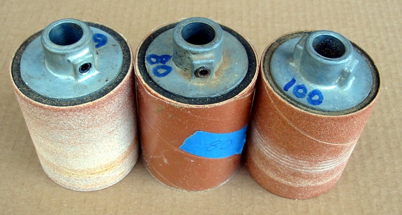

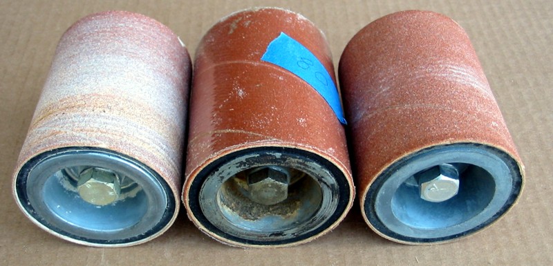

Chuck/Bill/John/Whoever,
I would be interested in seeing your Shopsmith drum sanders that are 'lefty/tighty'. Below are two snaps of my Shopsmith drum sanders. To tighten the sleeve on all of these drums you turn the bolt heads clockwise (righty/tighty). Thanks in advance.
[ATTACH]12718[/ATTACH]
[ATTACH]12719[/ATTACH].

SDSSmith wrote:Chuck/Bill/John/Whoever,
O.K. Pics tomorrow evening..... Checked mine today - they are all left handed thread, except for the one that fits directly onto the 5/8" spindle - I didn't check that one:o . Of interest - The drum sanders I'm talking about have the nut on the inside of the drum, rather than the outside. Therein lies the difference of "tightening when on the main spindle.

charlese wrote:O.K. Pics tomorrow evening..... Checked mine today - they are all left handed thread, except for the one that fits directly onto the 5/8" spindle - I didn't check that one:o . Of interest - The drum sanders I'm talking about have the nut on the inside of the drum, rather than the outside. Therein lies the difference of "tightening when on the main spindle.
It appears that I was talking about 'apples' (2-1/4" drum sanders) while you were talking about 'oranges' (extra long sanders, item E on this page). I have these and mine do have a left hand thread with a nut.

Actually no need for photos any more. Confusions has been resolved. Wonderful what a couple of pics will do!:)
