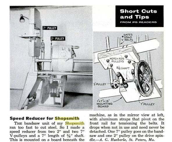

I stumbled onto this thread while trying to figure out what I just bought. It is a 1980 MV but the top accessory hub has been modified to a pulley with a series of belts that go to pulley mounted below and then back up to pulley on the bandsaw where the power hub should be. Any thoughts about what is going on here? The original owner has passed. Thanks, CJ

Does your setup look like this?:
[ATTACH]13409[/ATTACH]
If so, the article explains.............:)
article jackshaft.jpg (80.92 KiB) Viewed 3729 times
Peter

prmindartmouth wrote:Does your setup look like this?:
Yep, that appears to be it. Hmmm, what to do with it?

This picture while called a speed reducer does not change the speed. For it to be a speed reducer you would need for the pulley sizes to be different. 2/7 * 7/2 = 1. What am I missing?
Paul Cohen
Beaverton, OR
peterm
Posts: 576
Post by peterm »
The lower shaft turns at 2/7 the speed of the SS spindle. Then the 2/7 to the bandsaw reduces once again.
Peter
paulmcohen wrote:This picture while called a speed reducer does not change the speed. For it to be a speed reducer you would need for the pulley sizes to be different. 2/7 * 7/2 = 1. What am I missing?
Paul, this is not a math problem; it is a series of pulleys and belts.
For every 3 1/2 rotations of the drive shaft the first large pulley will rotate 1 time (a 7:2 reduction). Now, since the first large pulley and the second small pulley are on the same shaft, they turn on a 1:1 ratio. The second small pulley must turn 3 1/2 times to cause the second large pulley to rotate 1 time (another 7:2 reduction). Thus, this arrangement produces a 14:2 reduction in rotational speed.

http://mkctools.com/jackshaft.htm
Perhaps the original article - its from Popular Mechanics back in 1960
http://books.google.com/books?id=9tsDAA ... th&f=false
