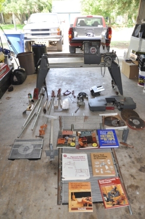

My friend's wife said she would like to post the SS on Craigslist to see how much they can get:( . On the bright side, i've got two appointments tomorrow to look at SS for sale! I will come back with something soon for around 400. I've learned that you probably have to hunt for a long time to find one that works for less than that. Hopefully I'll be posting pictures very soon. Then I can oficially be part of the club.

I found a great shopsmith this weekend! It needs some maintenance but the owner started it and it sounded awesome. More pictures are coming but it does have a lot of surface rust. Without doing a full restoration, is there an easy way to get rid of rust? I've already started with wd40 and a scotch brite scrubber. That seems to be working well. Any comments on what I should do are welcome!
