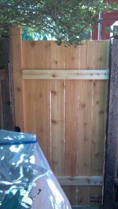

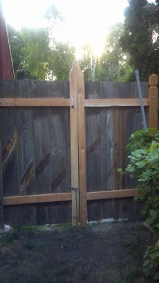

Post by WmZiggy »
I rebuilt 300 feet of cedar fence - 33 new 4x4 posts and 2 double and 1 single gate. I reused the siding boards. I've always let them go silver with oxidation - way easier than finishing them every couple of years. If you don't like that look, you do the painting. On the gates I used mortice and tenon with pegs and exterior glue. I haven't had any problems with the through tenons, and by going all the way through the stiles I elminated the cross or 'Z' brace. I haven't had any problems so far. Also, by going through the stile or upright it should help water stay out of the joint.
