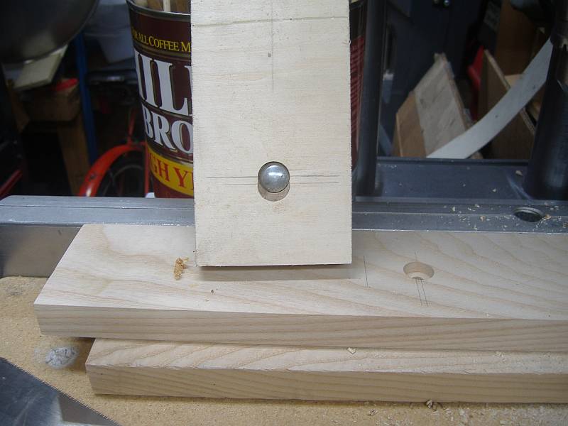

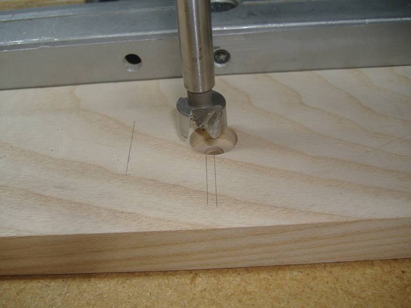

For purposes of this post we are going to say the 1-1/2" distance was fine but you somehow were off on the distance between hole.
Could have been an inch
[ATTACH]14112[/ATTACH]
Or maybe just an 1/8", doesn't mater much we need to fix it.
[ATTACH]14113[/ATTACH]

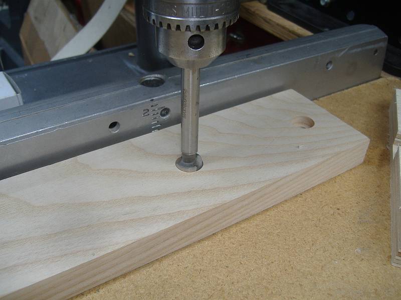

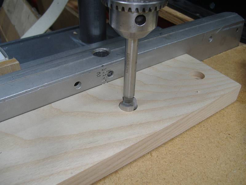

In any case we need to get back to the same setup we used to drill the countersunk holes the first time. Since we have the correct fence distance we can use the existing hole to get back to this. Put the same 5/8" bit in and slowly lower it into the existing hole, take your time you might find it goes easy or it may take some playing with.
[ATTACH]14114[/ATTACH]

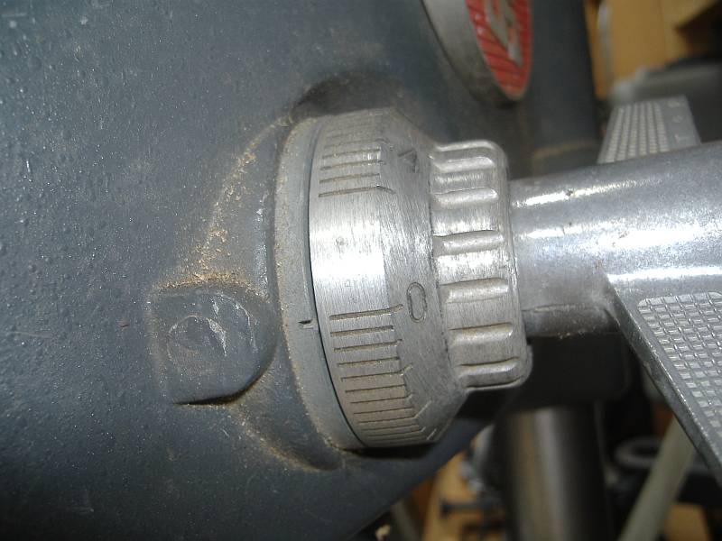

Lock the quill in that position and then adjust the fence so the edge of the workpiece touches along its whole edge. When you get it right lock the fence in place and test by withdrawing the bit and seeing if it goes back in the hole with the work piece against the fence. It might be hard the first few times but again it is one of those things that are helpful to learn.
[ATTACH]14115[/ATTACH]

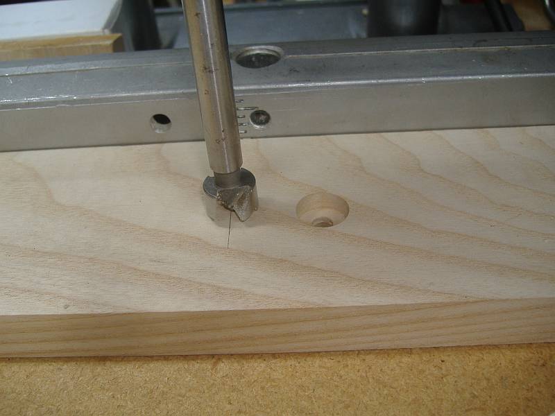

Before you move on you can also adjust the depth of cut, with the bit bottomed out set the depth stop.
[ATTACH]14116[/ATTACH]

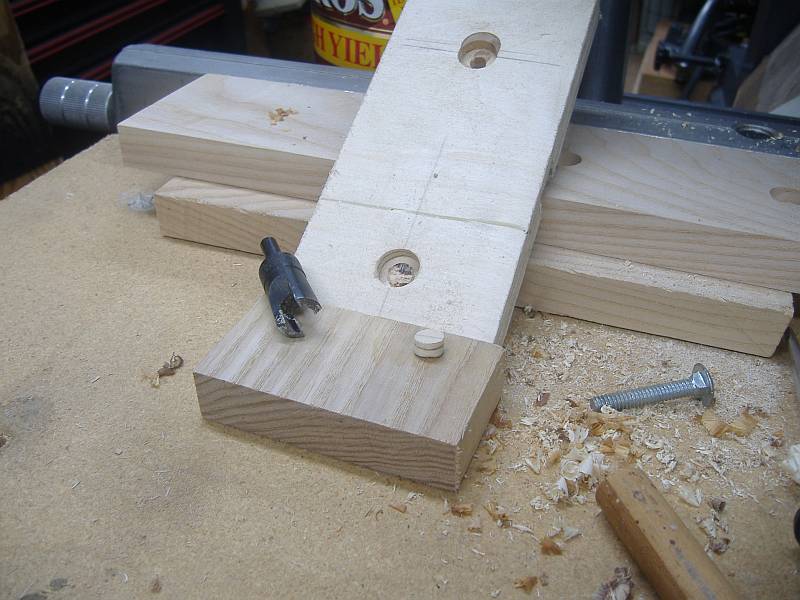

The easy way to do this is to plug the hole. You might want to use some wood filler, or maybe you have a tool like this that cuts plugs, and tenon dowels. If you were to have some of the wood left over after the project the plug cutter would allow you to match things up pretty well. In this case the grain is very different so it is not much of a match.
[ATTACH]14117[/ATTACH]

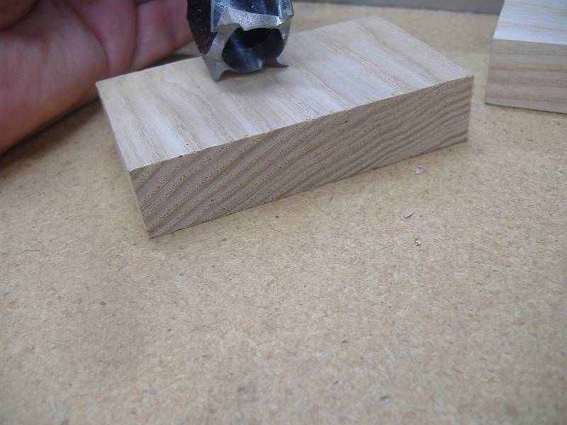

Most beginners are not going to have this but might have a simple plug cutter. Pictured is just one of the styles on the market. They work by cutting the wood like a drill bit but leaving the center portion to be used as a plug. In this photo I cut this plug in some plywood to show you an example.
[ATTACH]14118[/ATTACH]
Other options might be more attractive to you. Dowels come to mind and they do come in oak so you might get a good enough match... or go contrasting color. In this case I'm trying to make it easier to see. You can of course make your own dowels on the lathe or for those that can a router works for that too.
Dowels don't come in all sizes or you may not have the correct size in the shop so you can always turn a larger one into a smaller one. Today I looked in my coffee can of stub downs and found this piece.

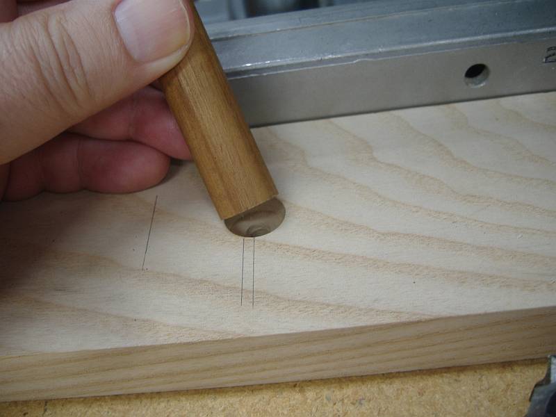

In this shot we see that we have found the hole to be off by 1/8".
[ATTACH]14120[/ATTACH]

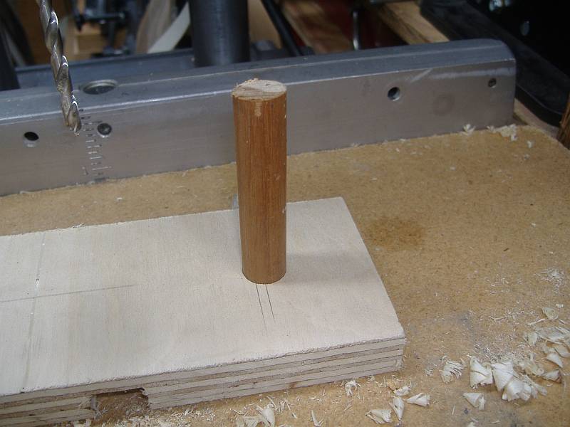

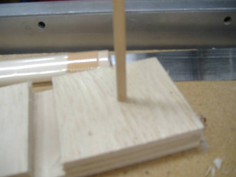

We have picked a dowel of the correct size, now it needs to be glued in place. Make sure it is bottomed out in the hole and you have enough glue on the sides of the hole and not too much on the bottom as it will come out the through hole and can make a mess.
[ATTACH]14121[/ATTACH]

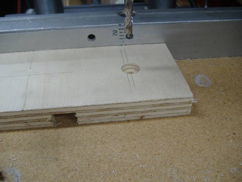

Wait for the glue to set for a moment and check the underside and make sure you are not having glue problems there. We didn't talk about the through hole but you will want to patch that as well. It is a 1/4" and again a dowel works well. When you flip it over you many find you have enough glue coming out to just stick the dowel in and give it a twist or two to spread things around enough.
[ATTACH]14123[/ATTACH]

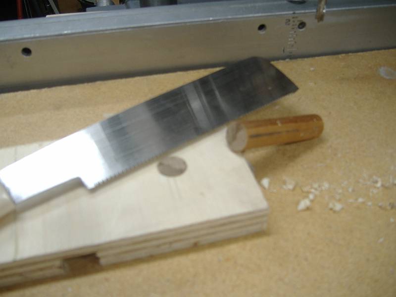

After the glue is set you can cut the dowel off flush with the surface on both sides. I have a flexible no-set saw that is made for this. You may have to make do with a regular saw and sand flush. So here a shot of the dowel cut off and the saw that did it.
[ATTACH]14122[/ATTACH]

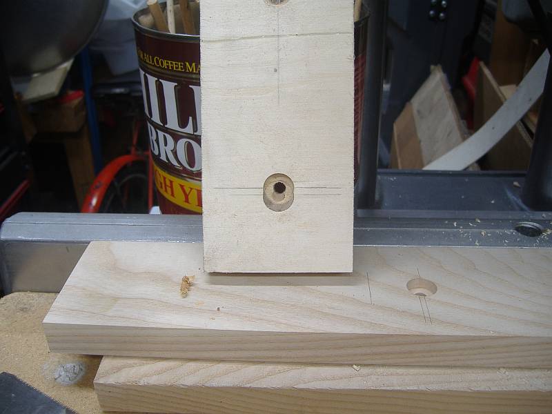

With the plugs in place you now re-drill the holes at the correct location. Do make sure you get it right this time will you.
[ATTACH]14124[/ATTACH]
