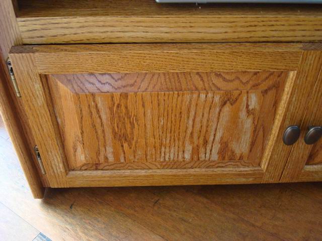

While some projects are not complete successes, no project is a flop. Even if you end up using the remains for firewood, you have learned something - thus "no flop".magnaman wrote:I made a simple TV cabinet with raised panel doors for the DVD, etc. Used oak plywood and red oak lumber. Finish was 1. Minwax pre-stain 2. 3 coats Minwax oil based Golden Oak stain 3. Minwax polycrylic finish.
It looked great when it was completed but now it is blotchy with large patches of what looks like no stain at all. And the grain has raised and it needs to be resanded.
What went wrong?

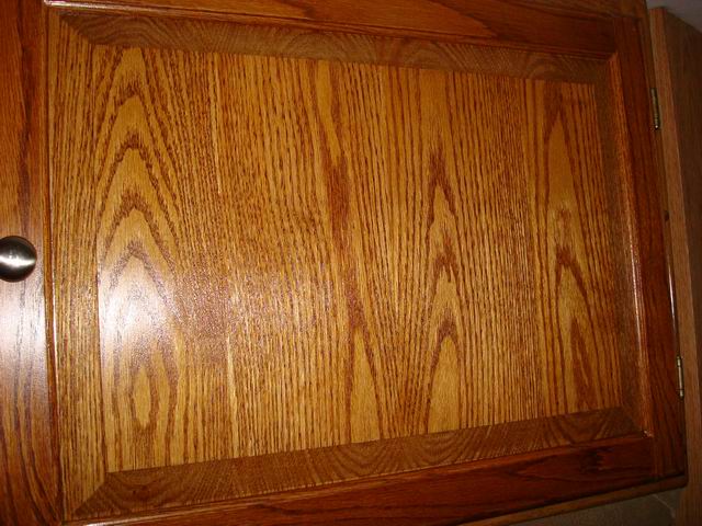

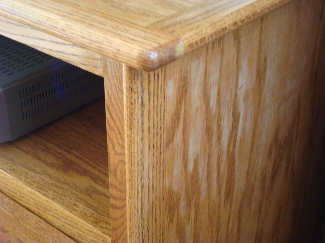

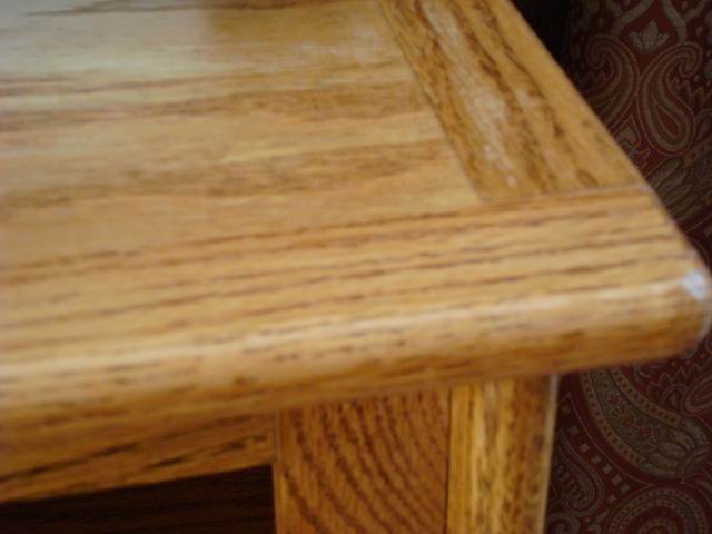

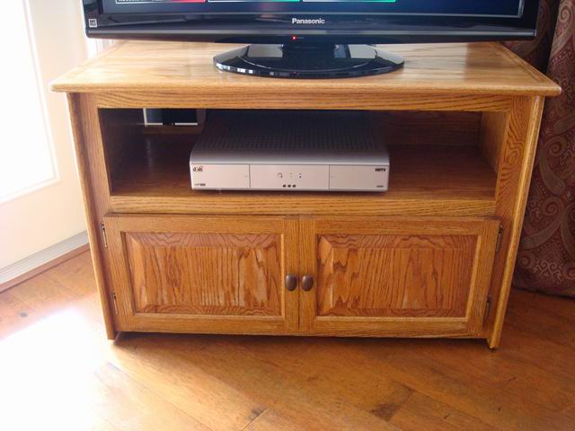

I have tried to attach some pics. The first four are from the TV cabinet and the last one is a raised panel door I put over a TV cabinet in the motorhome. I included it because I used the same Minwax pre-stain and stain as the TV cabinet but used Minwax oil based polyurethane instead of the polycrylic.
The prestain can says to apply the first coat of stain after 15 minutes so that is what I did in both cases. I did sand the polycrylic between coats but I did one coat in the early morning before breakfast and the other just after supper. I don't remember how long between stain coats.

To me that looks like blushing and is caused by not letting the stain throughly dry. Or it could be oil (silcone) or glue contaiminationmagnaman wrote:Thank you for all the replies. They are very helpful.

It may be that you got too much pre-stain in certain areas. Pre-stain seals the wood somewhat, so too much of it will seal it and prevent the stain from being absorbed into the wood. Again, you don't need a pre-stain on oak, as it's primary purpose is to prevent blotching on woods like pine, maple and cherry.
Also, you're better off sticking with either all oil-based products or all water-based products when finishing, in order to prevent compatibility problems.
If you strip off the water-based topcoat, you may be able to use an oil-based gel finish which combines both varnish and stain. Apply small amounts of the gel finish over the lightly colored areas, trying to blend it into the surrounding areas. After that dries, cover the entire project with a coat or two of the gel finish.

That does look like the stain failed to absorb. I would strip and redo. That doesn't look isolated to one area.
I almost never use a pre stain/sealer of any type except on end grain. Use a good oil based stain and then an oil poly. You can even use a spray can of the oil poly to lay down nice even coats sanding between. If you have any interest in polishing it then you need to do many coats, if not then just do 2 or 3 to make sure the finish is even.

I disagree on the pre stain Oak has very open pores and stain will soak into them and makes the wood look artificial. Pre stain will seal those pores so the finish goes on even.
Yes I know most everyone is use to seeing oak with deep dark pores. Unless they see it without then they will want to stain it that way.
I still think it was either contaimination or not a long enough drying of the pre stain.
I would sand, and if were me I would wet sand using clear Watco Oil, Tung oil or Boiled Linseed oil as a lubricant for the wet sanding. What will happen is the sanding dust will be forced into the oak pores and seal them. Then a thinned coat of Poly and then a full coat.
I would wet sand with oil and wait at the very least one day. Then I would coat the thinned poly and wait probably 2 days and then I would do the finish coat. After the oil finish is dried you will be able to tell if you got all the contaminate off or not. If not just sand it some more and do again.
