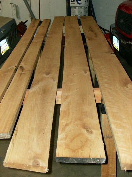

garys wrote:I came across a local guy who has some Wisconsin rough sawn cherry in his garage that he has had there for over 10 years. He is selling it off for $2 bd/ft. Living in a part of the country that has no wood, this looks like a true deal to me, so I bought some this week and hauled it home. I have no project in mind at this point, but my Wife said I shouldn't pass it up.
Hopefully I will get the planer out soon and plane it down to see if I made out OK, or I made a mistake....
Did the guy have the wood stacked properly, and spaced with stickers between? If not, it may still be green inside of the stack. Try some on the planer and let us know how it goes. Picture are acceptable here as everywhere on the Internet. :-) I hope you hit pay dirt on this find. I've been trying to find good pieces of black cherry large enough to make a salad bowl and platters (on some one else's Powermatic lathe).

I planed the wood yesterday. Most of it turned out very nice. Like all rough cut wood, there are some flaws in it, but I suppose that is part of getting a better price. Supposedly, this wood was cut at a Wisconsin sawmill over 10 years ago, kiln dried, and then he brought it to North Dakota. The boards I bought were very straight, so I'm OK with that. All but one board cleaned up at about 1 1/4" thick. The remaining one needed to be taken down to 1".
The garage smells great with that fruity smell cherry gives off. :o

Any pics of the planed wood?
garys
Posts: 2075
Location: Bismarck, ND
Post by garys »
Here is some of the planed cherry. Since it was rough sawn, there will be more waste than if I had bought finish planed wood at my wood supplier, but I feel I got my money's worth on it.
