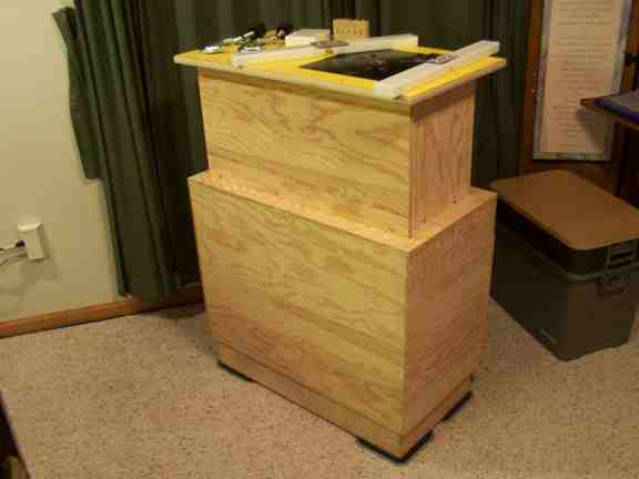

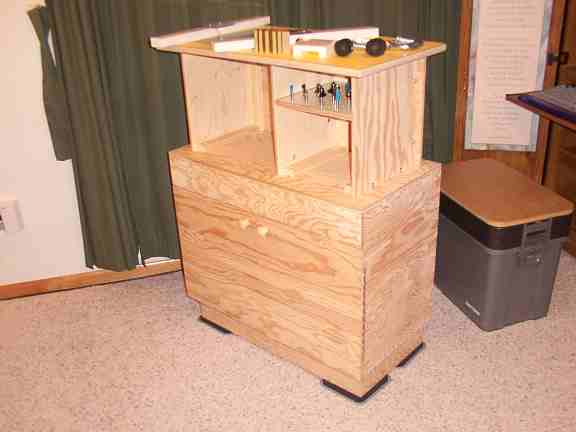

Some years ago I got to watching the Router Workshop guys. I first watched it "just because it was there" and it was woodworking. I thought that it was going to be kind of putsy and doing all manner of woodworking on a simple little router and leaving most of the "real" woodworking stuff sitting. The more I watched the more impressed I became... :) There really was method in what they were doing.
I have owned several (mostly crappy) little router tables and finally sold them or gave them away. The more I looked the more I became convinced that their simple little setup is all I need.
I have not built one yet but want to soon. Obviously I will make a few simple changes but probably not that many. Mostly just more dust collection and I will build it on a Shopsmith mini frame with casters.
Like much of the planet I always wondered what the back of it looked like since it was about as unseen as the far side of the moon used to be. I recently found a couple of pictures of one made from the plans they sell at the site and one was of the mysterious "back side". :)
[ATTACH]15909[/ATTACH]
[ATTACH]15910[/ATTACH]
