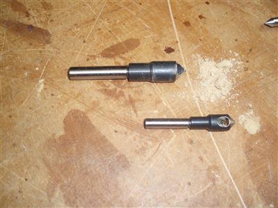

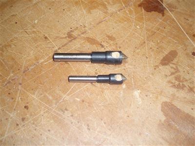

The new countersink bits that I got from Lee Valley work OK.
They perform a bit different than I had expected but I do get a clean, round hole. They seem to work about the same whether I drill the through hole first or after I drill the counter sink.
I have sorta come to the conclusion that my original discontent was created by my own "poor technique". I drilled a lot of holes yesterday, trying to compare the various counter sink bits in a variety of scraps (reduced the quantity of those doing so). Making certain that drill speed is low and stock is held firmly in place make a lot of difference.
These new bits, however, do introduce a new issue. They can get clogged up with the debris. When clogged, they don't work so well, duh.

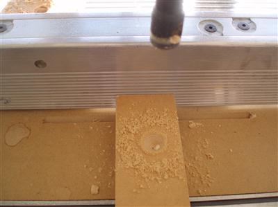

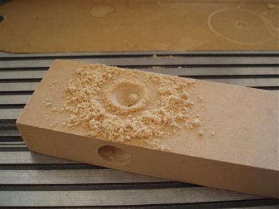

When I look at your pictures it leaves me to believe you are getting dust coming out... I think you are running the bits too fast and or feeding to slow.
Up for another round of testing?
If so set the depth stop for the depth of countersink you want. Slow the rpm down and then feed fast. You should see more like shavings then dust.

Yes, I would normally expect shavings from this sort of cutter but
shamefully, I am guilty of having not disclosed all pertinent information.
These bits were clogged while drilling in some scrap mdf veneer.
After reading your comments, I went out and drilled a couple holes in real wood. These bits do produce shavings, all be it small shavings.
Thank you again for your keen eye and for your skilled observations.
Hopefully everyone learns as much from your postings as I feel I do.

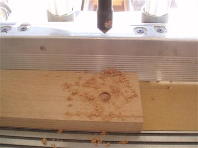

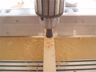

A Little More Analysis
Holes in a piece of wood and in a piece of MDF all cut at same low speed.
Shavings or Dust

Maybe moisture content of the MDF has something to do with it?
Turning green wood usually gives long shavings, while turning the same wood species when dry gives smaller shavings, or sometimes small chips or dust.
I would expect Dusty's MDF has a much lower moisture content than Ed's MDF.
Just speculating...
