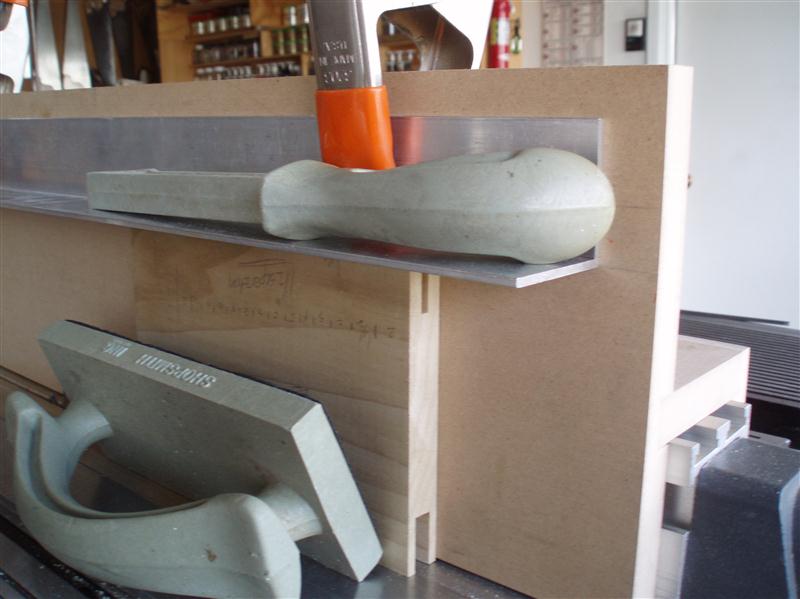

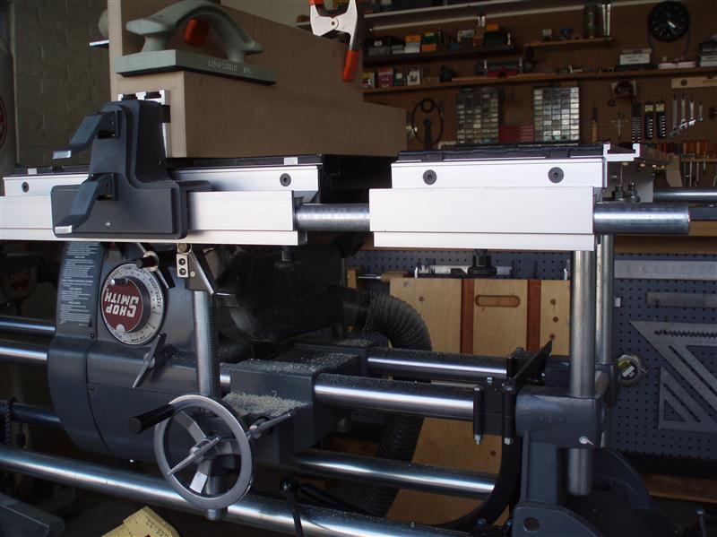

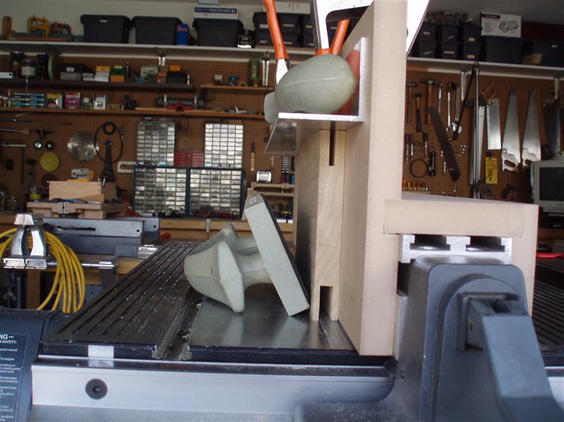

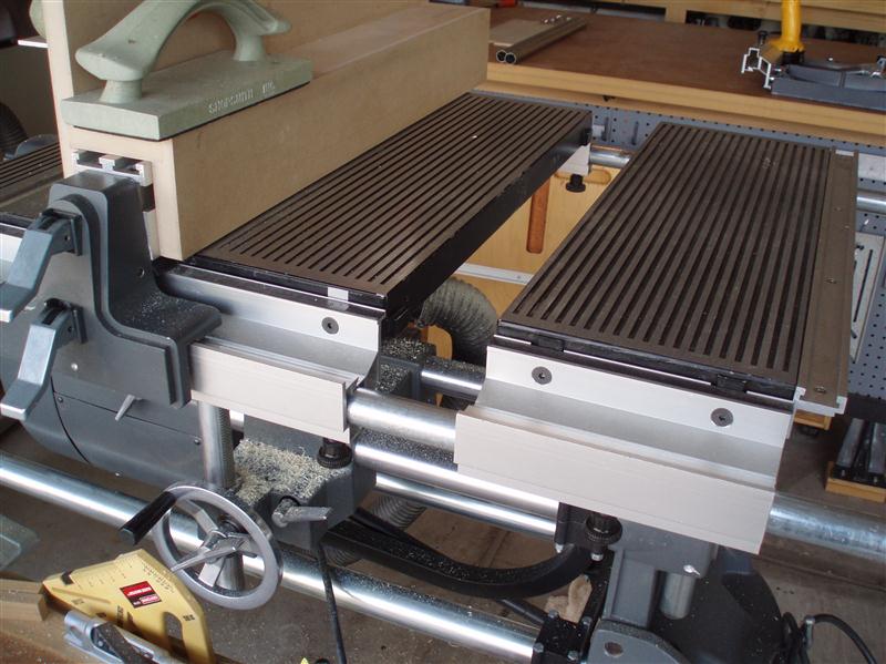

I have a device that straddles the rip fence for this sort of work. Please ignore the piece of angle aluminum in the attached photos. That was a "failed" experiment.
These images at least show the tall rip fence.
[ATTACH]16514[/ATTACH]
[ATTACH]16515[/ATTACH]
[ATTACH]16516[/ATTACH]
[ATTACH]16517[/ATTACH]
SORRY About This. These photos are posted in the wrong thread. They have nothing to do with the jointer. I guess ya'll already know that. SORRY Again.

dusty wrote:I have a device that straddles the rip fence for this sort of work. Please ignore the piece of angle aluminum in the attached photos. That was a "failed" experiment.
Thanks for the pictures. I have a similar extended fence set up for my Iowa shop TS .
Do you fasten the axillary fence to the main fence or do you let it float? If you let it float why?
Glenn
