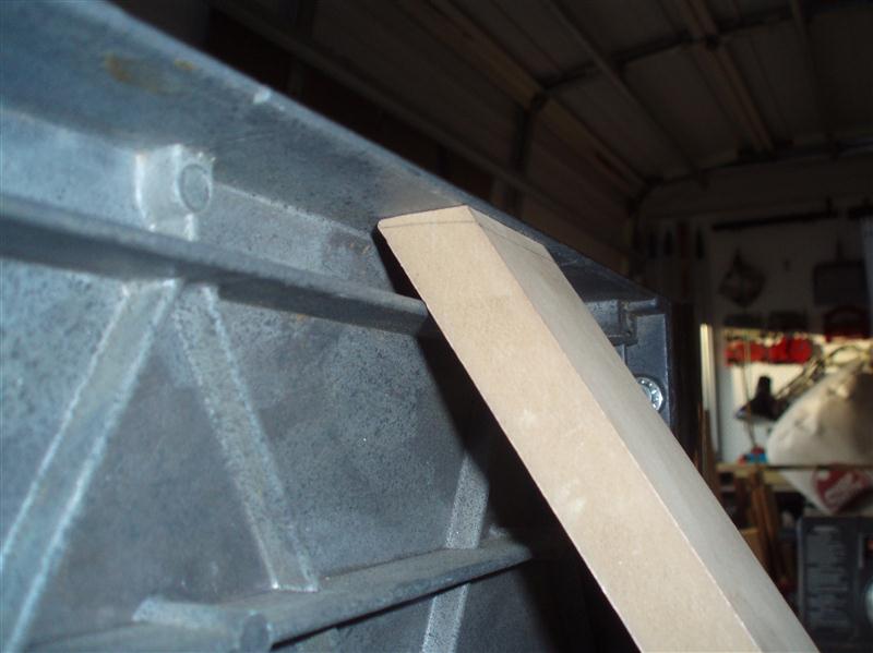

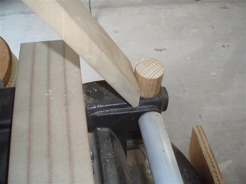

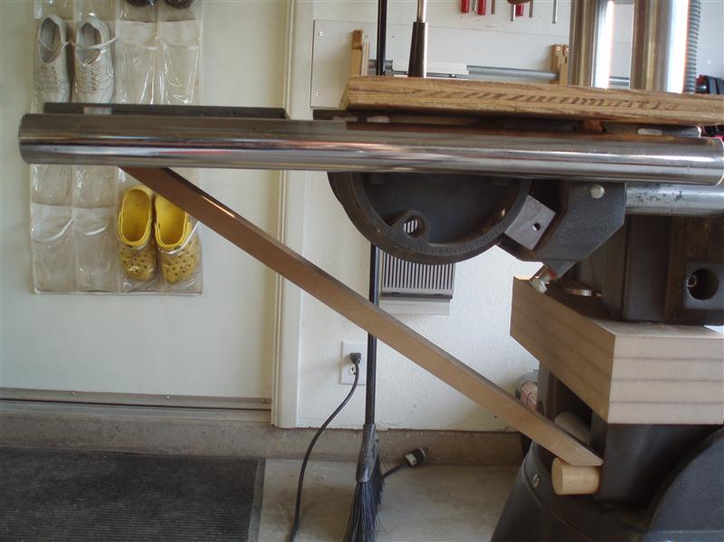

We have talked about it and here is my solution. A cheap and dirty drill press table stabilizer made from the cutoffs.
[ATTACH]17821[/ATTACH]
[ATTACH]17822[/ATTACH]
[ATTACH]17823[/ATTACH]

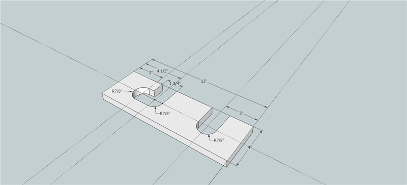

Dusty, I really like your idea for fixed-positioning the carriage in drill press mode. Would you be willing to share the dimensions of the cut-outs of your inserts? Hank
hjlssfor1 wrote:Dusty, I really like your idea for fixed-positioning the carriage in drill press mode. Would you be willing to share the dimensions of the cut-outs of your inserts? Hank
I will but I'll have to measure them and create a simple drawing.
I did that before I built them but for some reason discarded the Sketchup file. This a strange for me because I normally "keep everything".
Here it is:
[ATTACH]17950[/ATTACH]
Heighth Gauge Pattern 4 (Custom) (Custom) (Custom) (Custom).png (62.04 KiB) Viewed 2502 times
dusty wrote:I will but I'll have to measure them and create a simple drawing.
Here it is:
[ATTACH]17946[/ATTACH]
Width optional!:D Thickness as well.
Here it is:
Dusty, many thanks. I think I can figure it out, but I have to check to see how big a forstner bit I have. Hank
hjlssfor1 wrote:Dusty, many thanks. I think I can figure it out, but I have to check to see how big a forstner bit I have. Hank
I did not annotate that dimension. I apologize. The holes are 1 3/4" in diameter.
JPG40504 wrote:Width optional!:D Thickness as well.
The ones I made are 4"x13" and are 3/4" thick. Yes, these dimensions are optional. I have one that is 1/4" thick and another that is 1/2" and I plan to create a couple more that are 3/4" thick.

sailseahawk
Posts: 42
Joined: Sun Apr 08, 2012 4:00 pm
Tying to understand the issue
Post by sailseahawk »
Do I understand correctly that this jig is needed because your carriage slips down the tubes when you are drilling? The carriage on my shopsmith does not slide, even when mortising. Could that be because I have a 500, or because my tubes are a bit "rough" (not polished)?
Thanks!
Seahawk
sailseahawk wrote:Do I understand correctly that this jig is needed because your carriage slips down the tubes when you are drilling? The carriage on my shopsmith does not slide, even when mortising. Could that be because I have a 500, or because my tubes are a bit "rough" (not polished)?
Thanks!
Seahawk
I did not have a serious slippage problem but I wanted to avoid any at all. This Mark V is a shorty that is more or less dedicated to drill press mode and jointer.
As for why yours does not slip: it might be because you have a 500 but I think you have to tell me. Does the 500 carriage (and headstock for that matter) lock differently than does the 510/520?
