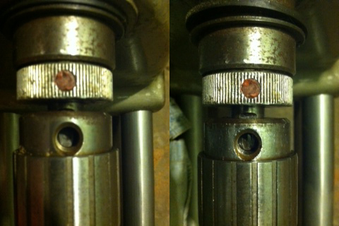

Ironically, I just came up from using rotation with a little forward urging. This definitely moved it further along the spindle. So, I continued rotating one way and then the other.
As well, when I decided to resort to a little tapping with the shims and mallet, the result was that the thing became a bit more intractable. Fortunately, I didn’t do much of that. Returning to the rotation, since it provided, as you put it, the first hint of daylight since I started working on it.
To say the least, it’s rather slow going but it has moved.
I’ve added some more oil and letting it marinate for a spell while I rest.
(i.e. laze off to keep myself from getting frustrated and giving up)
Seeing this decent bit of improvement, I’m going to check my local suppliers to see if they have any of the lubricants suggested earlier. Maybe that weird fork-looking thingy too.
Meanwhile, a comparison. Not perfect but close enough to see, perhaps arguably, an appreciable difference.
[ATTACH]20586[/ATTACH]
