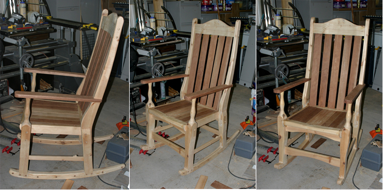

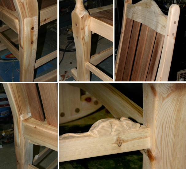

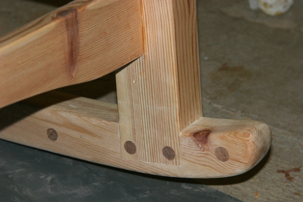

Almost There...
The final glue up is complete and the end of the build is in sight!
:eek:
[ATTACH]22003[/ATTACH]

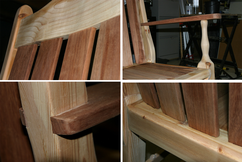

Overall I'm very happy with what I've achieved thus far; the spokeshave, surform and 80 grit sandpaper resulted in a nicely rounded shape that flows reasonably well. Some of the joints look pretty good; others required a touch of woodfiller. It's no Maloof and it doesn't really fit to any style I'm aware of but it'll do me
[ATTACH]22006[/ATTACH]
[ATTACH]22005[/ATTACH]
There's the mouse, if you look closely you'll see the ladybird/ladybug too
[ATTACH]22004[/ATTACH]

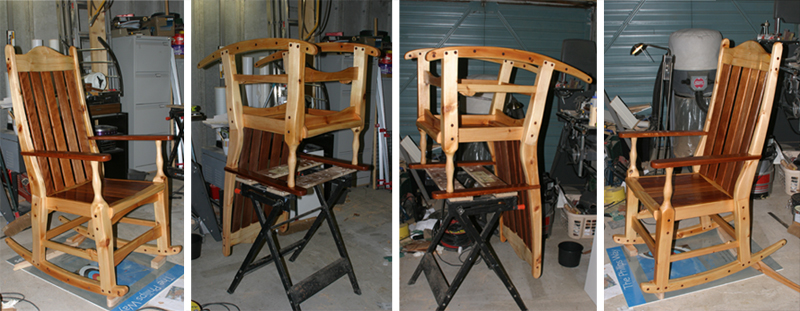

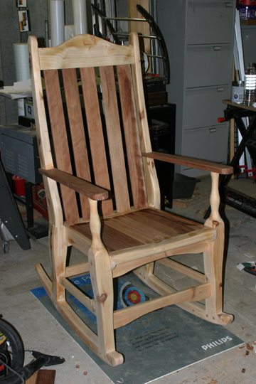

So here it is, all rubbed down (120, 180 & 320 grit) & ready for the finish - satin polyurethane varnish. First coat will be thinned 50/50 - apparently that helps it soak deeper into the wood to give a more durable finish. I'll follow that up with at least 2 coats of finish. The old display board is under it to protect the smooth base of the rockers from the concrete floor!
[ATTACH]22007[/ATTACH]
- assembled montage.jpg (323.23 KiB) Viewed 5732 times
- back details.jpg (361.31 KiB) Viewed 5733 times
- joints and mouse.jpg (333.65 KiB) Viewed 5736 times
- good joint.jpg (218.94 KiB) Viewed 5737 times
- ready to finish.jpg (202.72 KiB) Viewed 5731 times

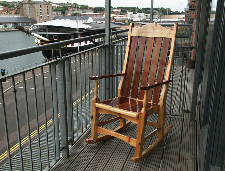

The Finish
It took a while; dozens of cups of coffee, several slaps on the forehead with a cry of "Doh!", a small amount of spilled blood, many mutterings, shouts and outbursts along the lines of "bother", "tsk, tsk", "oh fudge", "how irksome", etc.
But it's done, finished, complete, over ... what'll I do now???
Well here's what I did then:

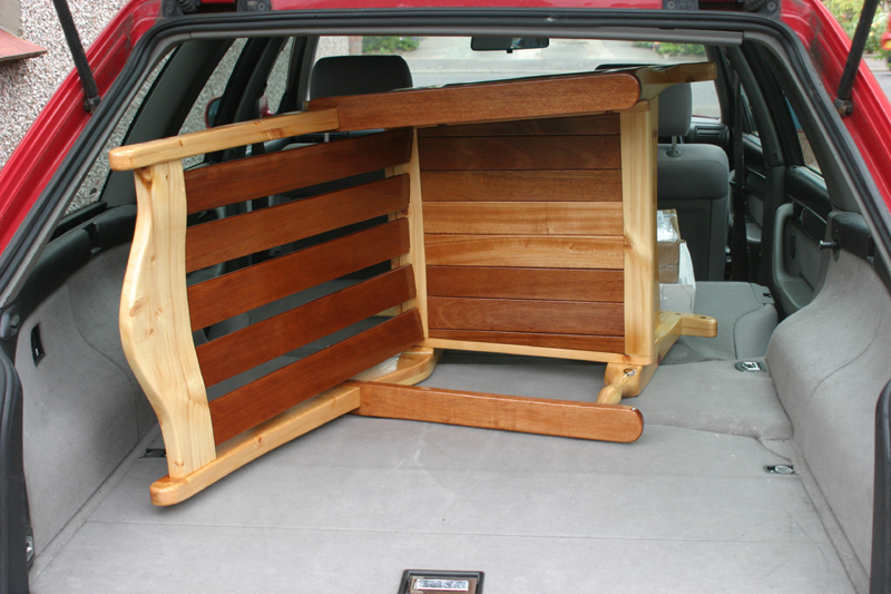

To finish the project: Varnish applied, 1 coat thinned 50/50, a second coat 60/40 and then 2 coats of straight varnish - satin polyurethane. A gentle rub down between coats with 600 grit. Out of all those coats I had 3 runs to deal with which, considering all the edges and places for excess varnish to hide before making a run for it (and my prior record in such things) I thought was not too bad. I was able to fix all 3 runs so it looks quite smooth now:
[ATTACH]22042[/ATTACH]
With the varnish dried and reasonably hard after about 36 hours, I got ready to load the chair into the car for the 100+ mile delivery journey. Of course, the previous evening, after admiring the finished chair, my dear wife just had to ask in passing if it would fit in the car - I told her it would. And then woke up in the morning with that seed of doubt sprouting in my mind - why hadn't I checked that measurement before starting the cutting & building all those months ago
But it was all right.
An inch or so to spare getting it in the door
[ATTACH]22045[/ATTACH]

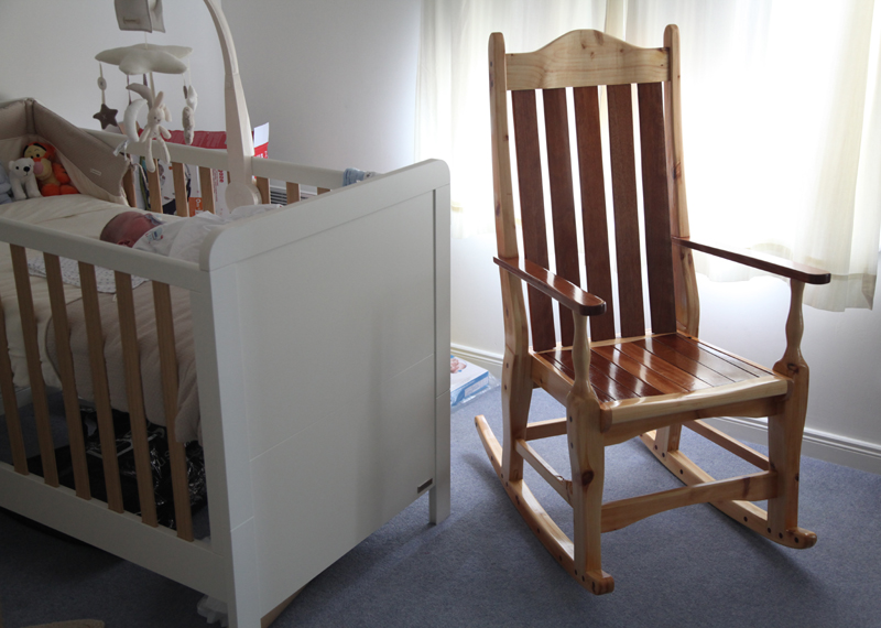

[ATTACH]22043[/ATTACH]
Not only did it fit - it worked (wee man now asleep in the cot):
[ATTACH]22044[/ATTACH]

- chair on balcony.jpg (472.65 KiB) Viewed 5660 times
- chair varnish.jpg (278.99 KiB) Viewed 5659 times
- Chair fits.jpg (345.6 KiB) Viewed 5660 times
- cot and chair.jpg (285.01 KiB) Viewed 5661 times
- In car.jpg (363.19 KiB) Viewed 5659 times
