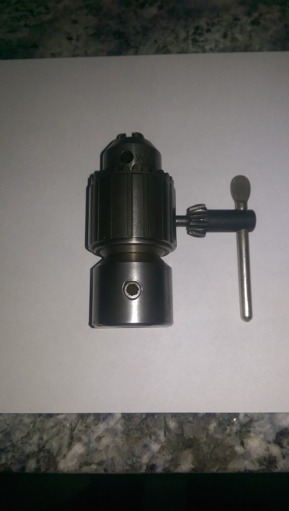

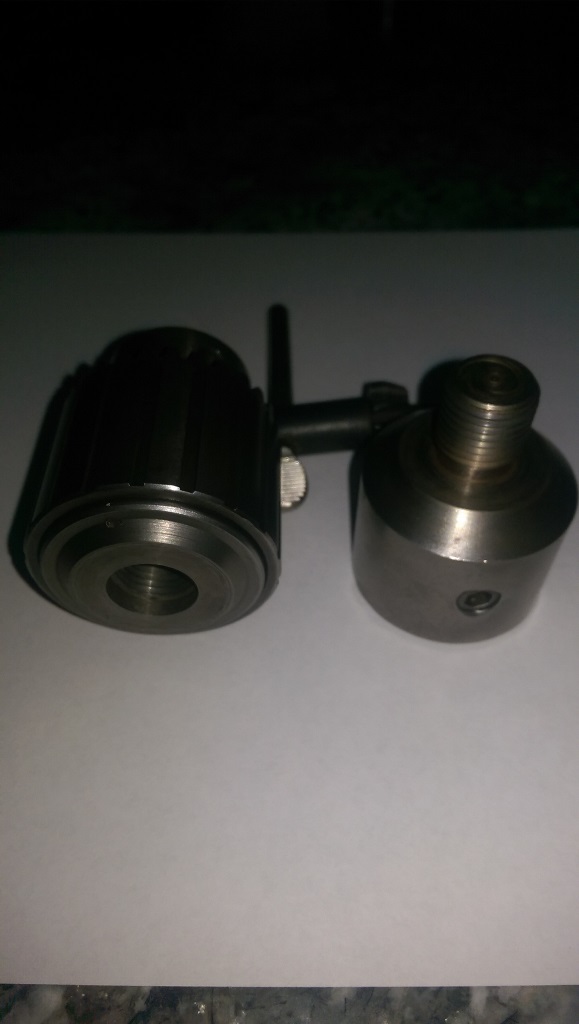

FYI, for those that said the chuck has no adapter that is not true. The 10E's came originally with a Jacobs 33B chuck. It had a 5/8-16 thread attachment. There was an adapter to adapt it to the SS 5/8 smooth shaft with a set screw. I am not sure when Magna changed over but somewhere along the line they got Jacobs to make the 3326 which just had the smooth 5/8 bore and set screw. No need for an adapter. And of course it has been the same ever since.fordtrax wrote:I WD40ed and LiquidWrenched in the allen keyhole. After about an hour it slowly moved and then pulled off. The pix helped since I did not know what was under it. Looks like a Jacobs 33b chuck or or something like that may made in Conn.?
- 10E Jacobs 33B chuck with adapter.

- 5/8-16 threaded adapter.

John, I've had a 10E and a 10E, model R-24996, and have not seen that drill chuck.
Sounds like ONE MORE item to put on my "collection" list. All the ones I have seen,
are the standard looking Jacobs "Shopsmith" chuck.
steve

Re: Can't Get Drill Chuck off 10e - Advice Please
I got that one on eBay a year or so ago. It is the only one I have ever seen. It could be that only the very first 10E's came with that chuck. My guess is that Magna bought the chuck (33B) from Jacobs and made the adapter themselves. Then when sales took off they got Jacobs to make the 3326 with the smooth 5/8" bore. Jacobs still makes the 33B in 3/8-24, 1/2-20 and 5/8-16 threads. It is now Model 33BA.skou wrote:John, I've had a 10E and a 10E, model R-24996, and have not seen that drill chuck.
steve
