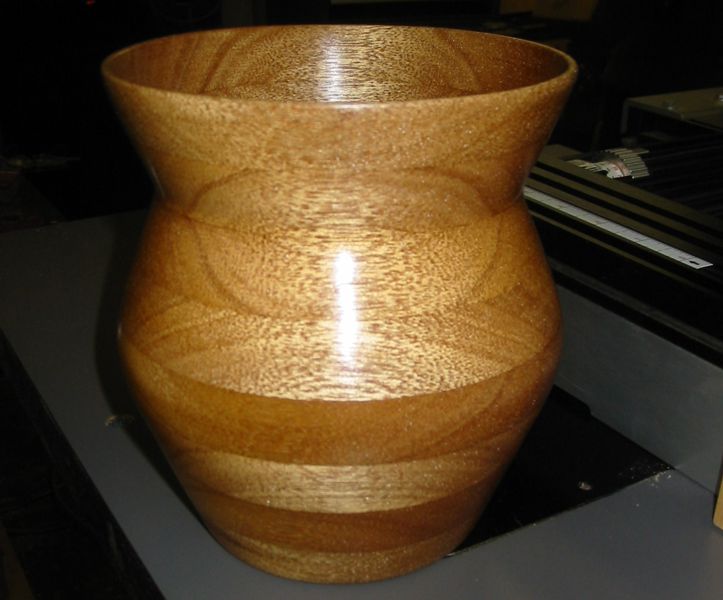

Here is one I am in the process of finishing for my wife.
[ATTACH]23572[/ATTACH]
ringmaster vase.jpg (60.24 KiB) Viewed 5654 times
Rob in San Diego

What is the wood ? How wide was your board ? How wide was your starting for width of cut ? That is beautiful work !!! You should be very proud of yourself.

2centsworth wrote:What is the wood ? How wide was your board ? How wide was your starting for width of cut ? That is beautiful work !!! You should be very proud of yourself.
As I recall it is some oak that I reclaimed from a neighbor. It seems to me I made a bunch of blanks that were about 10" square and 3/4" thick. I cut a bunch of rings and then assembled them into a number of different shapes and sizes. The rings were cut using the 5/16" indexing scale. I am just getting around to putting a finish on one of them for my wife's birthday.:D

Very nice job. I really like the grain match between the 2nd and 3rd ring
Bill V

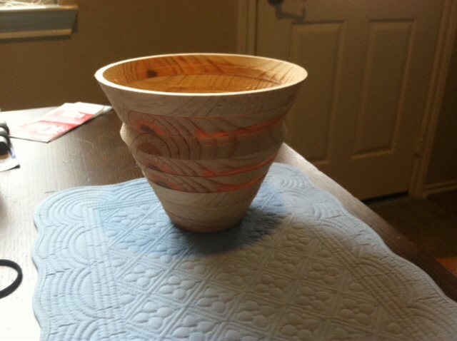

[ATTACH]
Not glued or finished yet just having fun. :D
Jerry Penny

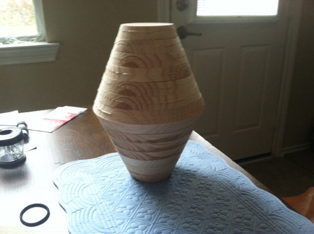

Another option...
Post by 2centsworth »
Another option.
[ATTACH]23605[/ATTACH]
Jerry Penny
