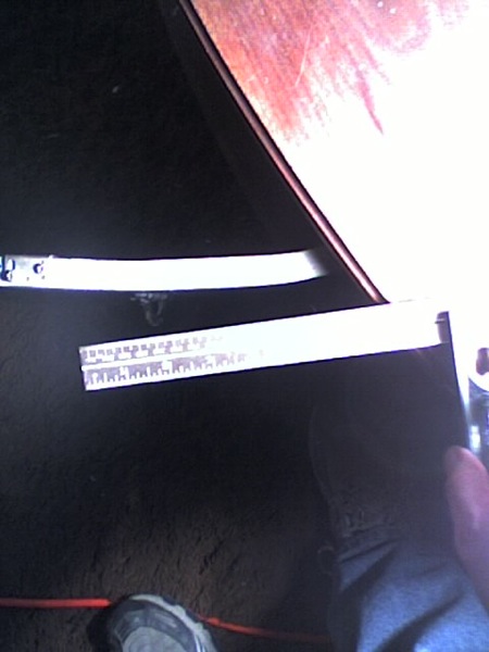

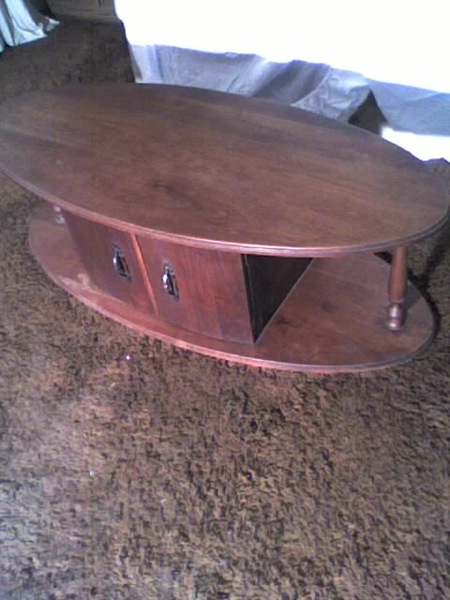

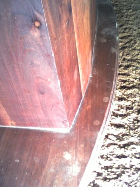

Well, I said I would try to get pictures of that coffee table where I used the tilting table to get a bevel cut. Here they are, but remember that this was a first project, and it has been around a long time. I finished it in tung oil, and I should have gone poly. One of these days, maybe I'll get around to refinishing it.
All of the cuts were rip cuts, so I rested them against the fence for the cuts using the miter gauge in the left hand and the right on the wood below the gauge.
