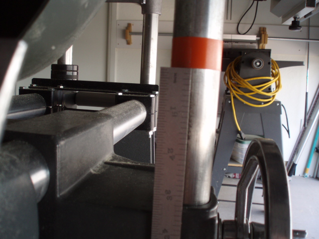

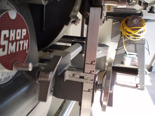

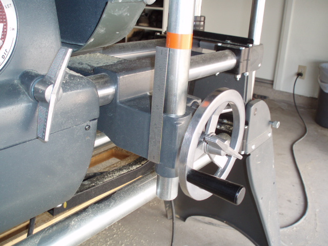

DEPTH GAUGE: I have attached a photo of a "concept" for the installation of a depth of cut gauge. I think the photos speak for them selves. The pointer would be attached to the carriage and the measuring device would be attached to the table.

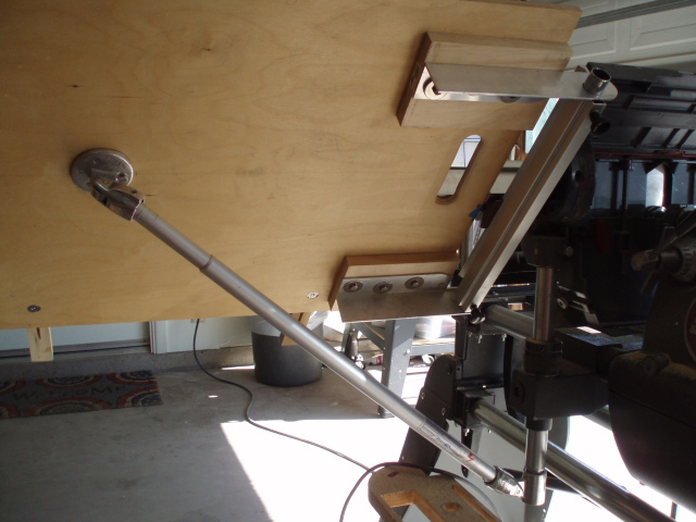

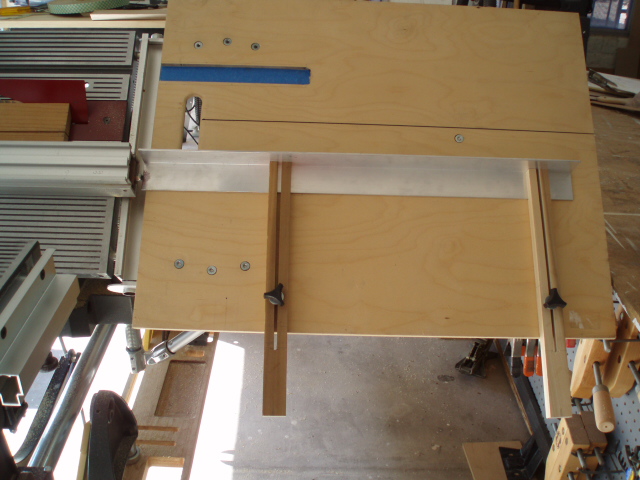

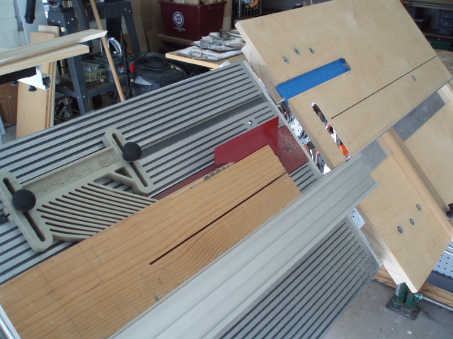

ADJUSTABLE TILTING OUTFEED TABLE: The prototype is done! It works, I used it last week to cut a bunch of bevel cuts for a neighber. The proto type outfeed table is attached to the main table and moves up and down and tilts with the main table. It is equipped with a riving knife and an adjustable rip fence extension.
Depth Gauge 1.JPG (147.85 KiB) Viewed 8819 times
Depth Gauge 2.JPG (152.6 KiB) Viewed 8812 times
Outfeed table and_Adjustable Fence.JPG (150 KiB) Viewed 8832 times
Outfeed table Support.JPG (144.22 KiB) Viewed 8828 times
Tilted Table and Accessories.JPG (159.73 KiB) Viewed 8829 times

Great job on the outfeed table and the riving knife. They look like they do exactly what they need to do.
The adjustable fence on the outfeed table...how is it attached to the ends of the guide arms? This looks like something I might want to do if I add an outfeed extension to my 500.
Thanks for posting the pictures. Your innovations are inspirational!

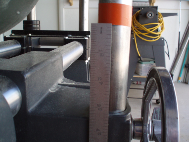

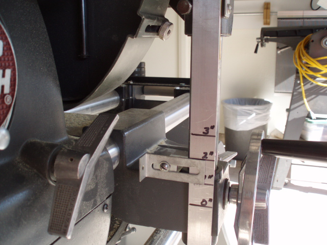

Mark V Depth of Cut Indicator
ed,
I sat looking at that kludge I concocked for a depth of cut indicator - NO WAY! It's much simpler!!
All that is really required is a measuring stick and a line on one of the main table tubes. I put a piece of orange electricians tape on a tube for a test.
See photos. I would also need a 6" ruler with a darker set of numbers and markings. I have one - but I use it all the time - can't devote it to this task. The table is horizontal and set for 0" depth of cut.
I've gotta remove and reinstall the table a few times to see if it reseats in the carriage the same each time.
Depth Gauge 1.JPG (138.92 KiB) Viewed 8814 times
Depth Gauge 2.JPG (146.33 KiB) Viewed 8804 times
Depth Gauge 3.JPG (145.42 KiB) Viewed 8796 times

I think you have a handle on the depth guage.

Dusty- The outfeed table looks great! And that's a nice easy solution to the depth gauge readout. I usually use one of the inexpensive plastic vernier calipers to measure the height of the blade above the table, but now maybe I'll try to figure out how to attach it to the post and carriage instead. Also, I've never measured it, but there should be some correlation between number of revolutions of the table height handwheel and inches of travel. Next time I set it up in saw mode, I'll try to remember to measure it.
But I do have a question- Under what conditions do you need a rip fence extension? I thought that once the wood was past the blade and riving knife, it was better to let the wood do what it wants to. Obviously if the piece between the blade and fence warps toward the blade, the riving knife is there to keep it from pinching the blade. But if it wants to warp toward the fence, and you have an auxiliary fence preventing it, won't that cause sideways pressure against the blade's back teeth and lead to burning the wood? Tell me if I'm totally off base here, it wouldn't be the first time!

Yes Dusty,
Please enlighten all of us as to the benefits that having that extended fence presents.
greitz wrote:Dusty........................But I do have a question- Under what conditions do you need a rip fence extension? I thought that once the wood was past the blade and riving knife, it was better to let the wood do what it wants to. Obviously if the piece between the blade and fence warps toward the blade, the riving knife is there to keep it from pinching the blade. But if it wants to warp toward the fence, and you have an auxiliary fence preventing it, won't that cause sideways pressure against the blade's back teeth and lead to burning the wood? Tell me if I'm totally off base here, it wouldn't be the first time!...........................Gary
Like Gary, I can't think of any..........my brain must be asleep or something?Image
Tim
With the table tilted, the stock on the outfeed side of the blade won't just lay there, it tends to slide down hill.
The fence helps to deal with that. If you work with a shop helper, it may not be necessary but I often work alone.
I don't do a lot of work with the table tilted but this last week has taught me that this configuration is a bit different than with the table horizontal. If you find yourself using the tilted table - be careful, think things through. Stay safe.

dusty wrote:With the table tilted, the stock on the outfeed side of the blade won't just lay there, it tends to slide down hill................
That is a good point, Dusty. I usually do those kind of cuts on my arbor tilting saw, so I was not thinking about the gravity problem.:o Thanks for the answer!

Dusty, I'm really digging your depth gauge, but, given the current incarnation, how would you remove it when you're doing any turning?
