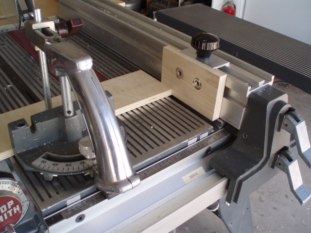

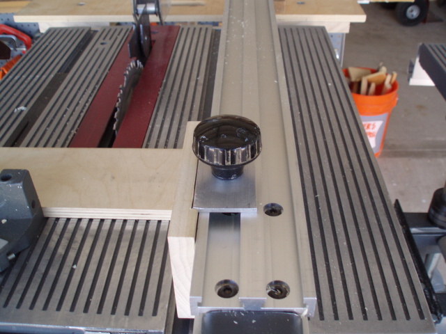

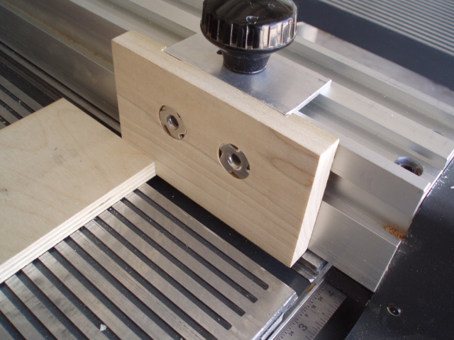

I need to ask something though. In the second photo (IMG-1701), do I see that you are using the rip fence in conjunction with the miter gauge. I see the red featherboard - is this the stop that you are using for length? Just don't let the "cutoff" get caught betweem the blade and the rip fence.
This is my attempt to avoid what could be a very unnecessary incident while cross cutting multiple pieces the same length. Typically, I leave this attached to the rip fence. I just move it to the other side if it's in the way. The knob gives me something to grab onto when moving the rip fence around.

That is a nice set-up, Dusty. Mine is simply a block clamped to my fence, and I must be sure that the clamp does not get in the way.:)

I was using the fence-mounted featherboard mounted to the rip fence as a stop. This way, the workpiece is not in contact with anything on the right side as it meets the blade. The one time I accidentally did this was because I had the workpiece too far forward past the stop, and when I slid it right to where I thought it was hitting the featherboard stop, it was actually hitting the rip fence itself. I'm glad I noticed quickly before anything unfortunate happened.

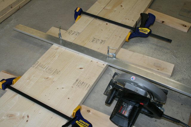

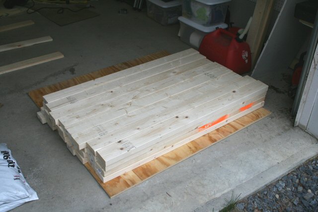

I made a bit more progress on my project today. The next step was to take 16 of the 24 2x4x8 boards, and cut them in half. I am building eight shelving units, four for each garage bay. Each shelving unit needs four 4' pieces. I picked out the 16 straightest boards, and cut them in half four at a time with my circular saw.
[ATTACH]1292[/ATTACH]

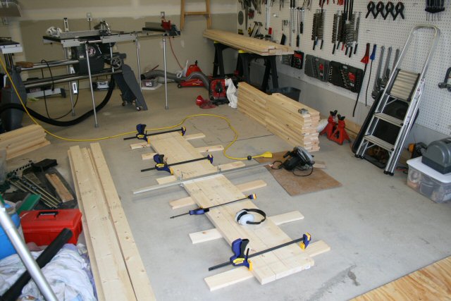

I grabbed six of my cut 1x4 pieces and laid them on the garage floor. I laid four 2x4s across them, and made sure the ends were aligned together. I then clamped the ends with bar clamps, leaving room under the bars for a tape measure. Once the ends were clamped, I measured exactly 48" from one end and made two marks:
[ATTACH]1293[/ATTACH]
Once the marks were made, I clamped an aluminum straightedge guide for the circular saw exactly 1 1/4" up from the mark. I know from experience that this amount centers the kerf on the mark. I then attached two more clamps on either side of the cut line to keep things stable as the each piece is cut through. After each cut, I numbered the pieces in sets of four, with the pieces in each set being exactly the same length. (For all intents and purposes, I think all the pieces are the same length, but I figure making this sort of thing a habit can't hurt.)
And the finished product:
[ATTACH]1294[/ATTACH]
Trivia fact - all of the 16 2x4s were precisely 96" long, except for one. That one was 1/8" longer. I marked the end to trim down later.

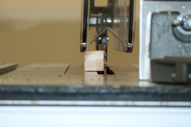

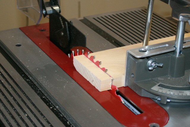

I cut the remaining pieces to final length today. This time, I was cutting on the right side of the blade and cutting a wee bit off the end. At first, I tried cutting with the guard down but I became uncomfortable with this because the trimmed piece was sometimes fitting inside the guard which then held it against the blade. In this picture I've positioned the workpiece and the trimmed endpiece where they end up as soon as the blade completes its cut:
[ATTACH]1350[/ATTACH]
As you can see, the workpiece does not reach the pawls or riving knife as the endpiece becomes freestanding. To keep the guard from potentially causing issues, I flipped the guard up and completed the remaining cuts without the guard.

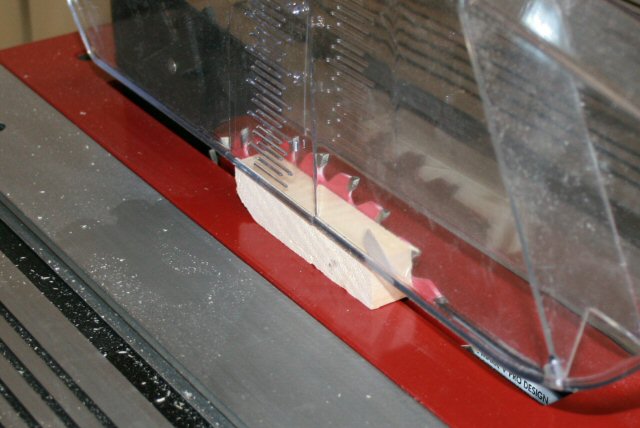

Here's a picture showing how the trimmed end tended to sit under the guard as the workpiece was removed from the right side of the blade:
[ATTACH]1346[/ATTACH]
Here's a closer look:
[ATTACH]1347[/ATTACH]
Since the guard wobbles laterally, sometimes the guard would actually fall down and keep the workpiece against the blade. Maybe a zero clearance insert would have been better for this sort of cut too?

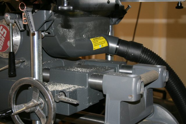

With the lower guard pulled out to close off the gap that Bruce had pointed out. Although I only made half the number of cuts this time (24 this time versus 48 last time), there was substantially less sawdust on the table carriage when I was done:
[ATTACH]1351[/ATTACH]
I also ran with the upper guard pulled up for most of the cuts, so that may be a factor too.

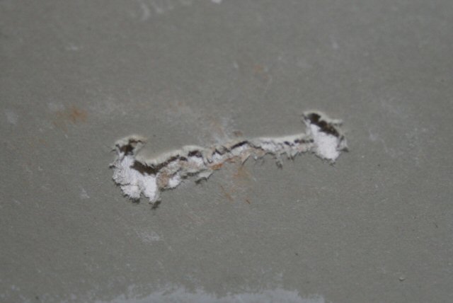

I began marking off the ceiling studs where the shelving will attach. I take absolutely no chances with things like this. First, I used a studfinder to mark the approximate location of the stud. Next, I used a Rotozip with the bit extended about 1" and plunged the bit in where I figured the stud would be. Since the bit was longer than the thickness of the drywall, it did not plunge in all the way. I moved the bit laterally to each side of the stud, and as soon as the bit fell in the whole way, I moved along the stud to make a mark. This results in an "I-beam" mark which tells me exactly where dead center is:
[ATTACH]1352[/ATTACH]
Since the 2x4 will be lag-bolted to the ceiling, it will cover all these marks up and I'll never see them.
Now that I know where the studs are, I need to work out how where I need to dado for the vertical shelving posts so they don't conflict with where the lag bolts will go. This will become clearer in time...
