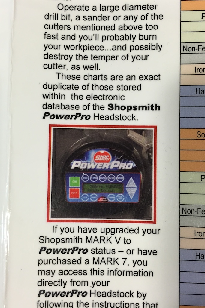

This chart says that it is an exact duplicate of the Power Pro electronic database:
http://www.shopsmith.com/ownersite/cata ... _chart.htm.
This chart is for the non Power Pro Mark V:
http://www.shopsmith.com/ownersite/cata ... dchart.htm.
Many differences. Drilling speeds vary by only 50-200 rpm, but, for example, the Belt Sander speeds for the Power Pro decrease with finer grits and increase on the non Power Pro Mark V, for a 500-600 rpm difference.

Just looked over the link you posted and I don't see the "exact duplicate of the Power Pro electronic database" words you mentioned........ yea old eyes don't see everything any more so could you point out where it says that?

The statement about the chart being a copy of the electronic database is on the chart itself. I can post a picture later, but it won't be until tonight.

Here, finally, are pics of the speed chart, and I can confirm that with the exception of one Scroll Saw speed setting missing from the printed chart, it is an exact match to the Power Pro database.
I don't know why the Belt Sander speeds are so different in new vs old speed charts.
Duplicate of Electronic.jpg (266.32 KiB) Viewed 15073 times
New Speed Chart.jpg (237.63 KiB) Viewed 15073 times
Old Speed Chart.jpg (317.52 KiB) Viewed 15073 times

Mike907 wrote:Here, finally, are pics of the speed chart, and I can confirm that with the exception of one Scroll Saw speed setting missing from the printed chart, it is an exact match to the Power Pro database.
There are two things that hit me immediately.
First, the old speed chart does not specify grit size so we do not know what Course, Medium and Fine actually refers to. That is not too important now given the second thing.
The second more glaring difference is that with the old chart the larger the grit the slower the speed. On the new chart the larger the grit the higher the speed. Both can not be right.
Since everyone has been using the old chart and speed dial for 60+ years my guess is that the new chart is wrong and if so then the Power Pro headstock is wrong. If this is true how does SS correct the computer in the PP head stocks already in the field?
Can someone with close ties to SS check with them on this discrepancy?
