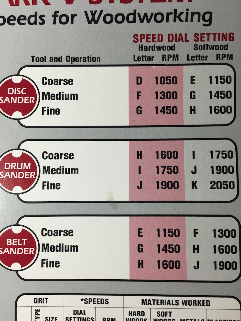

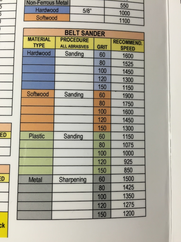

Here, finally, are pics of the speed chart, and I can confirm that with the exception of one Scroll Saw speed setting missing from the printed chart, it is an exact match to the Power Pro database.
I don't know why the Belt Sander speeds are so different in new vs old speed charts.
Duplicate of Electronic.jpg (266.32 KiB) Viewed 15086 times
New Speed Chart.jpg (237.63 KiB) Viewed 15086 times
Old Speed Chart.jpg (317.52 KiB) Viewed 15086 times
Re: SS Speed
Posted: Sun Jun 21, 2015 6:23 pm
by jsburger
Mike907 wrote:Here, finally, are pics of the speed chart, and I can confirm that with the exception of one Scroll Saw speed setting missing from the printed chart, it is an exact match to the Power Pro database.
There are two things that hit me immediately.
First, the old speed chart does not specify grit size so we do not know what Course, Medium and Fine actually refers to. That is not too important now given the second thing.
The second more glaring difference is that with the old chart the larger the grit the slower the speed. On the new chart the larger the grit the higher the speed. Both can not be right.
Since everyone has been using the old chart and speed dial for 60+ years my guess is that the new chart is wrong and if so then the Power Pro headstock is wrong. If this is true how does SS correct the computer in the PP head stocks already in the field?

I only posted pictures of the Belt Sanding speeds, but the newer chart calls for decreasing speed for finer grits in all sanding operations vs increasing speeds for finer grits with the older chart.

by jsburger
dusty wrote:My guess is that with the old chart the numbers are gross estimates that are intended to put you in the general range for the operation being charted.
The new chart, however, is a bit more scientific (exacting, if you will).
In both cases, remember that the craftsman has some responsibility in this matter too.
I see the number differences but I don't see any glaring errors.
You don't see the fact that the speeds are upside down between the two charts? :confused: :confused:
The old chart has lower speeds for the corser grits and the newer chart has the higher speeds with the courser grits. That is a total reverse. :confused:
